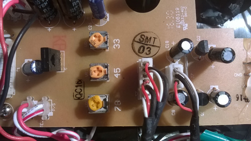

Thanks to everyone for your input . You have all offerd great solutions . As I said I'm new to electronics so I have a question.
To use your suggesion Nigel would I just remove the 78 trim pot and replace it with a linear pot of the same value or higher ?. The 78 pot says 101 , so I'm thinking its a 100 Ohms pot. I'll test it when I remove it .
If its a 100 Ohms trim pot what value standard linear pot would I repace it with ?
Heres a pic of the trimmers that control the pitch.
I've ordered the pwm controller , as soon as it arrives I'll be able to try other suggestions to find best solution. cheers
Notice that the 33/45 pots look to be 105, so that might be a better bet for a wide range control.
I would suggest setting it to 45 (or 33) and seeing how wide a range of control the existing preset gives you - and try the same with the 78 preset as well.
It might be as easy as replacing the 78 preset with a larger value pot.
