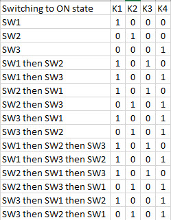

I'm new to this forum and hope that you can help me. I'm in the process of building a control cabinet for my home brewery. The brewery consists of three heating elements (3500W) but I only have available two 16A power feeds (220V, living in Norway).
The heating elements are controlled by 4 contactors, K1, K2, K3 and K4, where K2 & K3 are for Heater 2. To control the 4 contactor I have three switches, on my drawing showed as NO, but can I can add more NC or NO to these.
I've created a logic on how this should work, with switching sequence in left column. The main areas of concern is that K1&K2 must never activate at the same time. This also applies to K2&K3 and K3&K4. All the contactor have additional 1xNO and 1xNC that can be used. If needed I can also add more relays. The control voltage for the contactors are 24VDC.

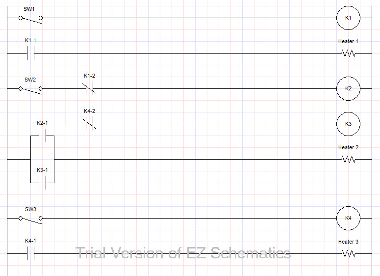

Attached is also a ladder diagram showing my thinking, but I'm stuck. No matter how hard I try I'm not able to solve this, it has been too long since my electronic exams.

Looking it over briefly it appears you actually have 6 state/combo's for the four relays, it might be simpler to use a 4 wafer 6 posn rotary switch, especially if not using an actual PLC.
You could then set the 6 binary states to pick up the four relays, you would need a break before make type.

Actually I only count 6 combo's?
The other 5 are just duplicates, the Custom wired Hex switch also takes care of the interlocking.
A Hex thumb wheel switch would also do it but wasted positions, and intermediate relays would be needed.

I'm looking for an interlock logic to prevent overload and short circuit. All the contactors have coil voltage of 24VDC.

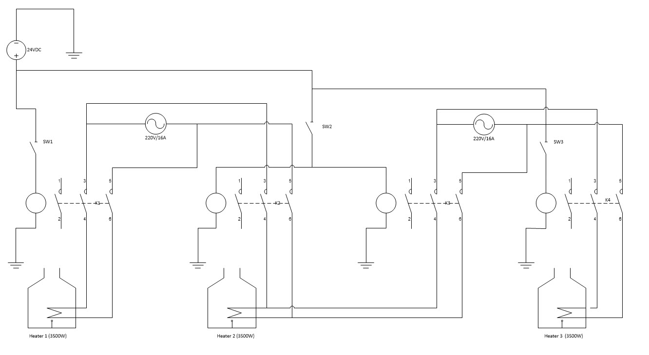

I have attached two more images hoping to explain better.

According to your schematic, closing S2 connects two separate AC power sources directly together. This is bad.

Thank you for your replies. I was originally having three AC inputs, but this will not happen, so hence trying to do the "same" job with two.
It is a one of build and home based. I could have made it all simpler, but i like to challenge myself and I want it to be safe.
I understand now that doing what I want just with switches and contactor will be difficult so I've started looking into using a PLC. Most likely I will use a Siemens Logo 24RC, but this time I will confirm the logics before purchase :)

I ended up using a Siemens Logic 8, and after a steep learning curve in "PLC" programming I managed to achieve what I intended.
