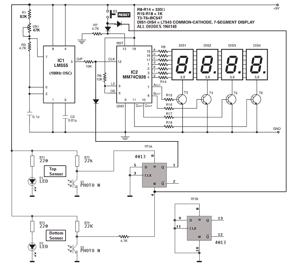

I am working on a small science project, and need assistance with the electronics part.
I have not been succesful finding an appropriate schematics.
It's actually very simple: I want to measure the drop time of different objects through a vertically mounted metallic tube (copper).
The objects will vary from a stone, an ordinary magnet to the strongest possible neodymium magnet.
At the top and end of the tube I want to mount IR-detectors that will respectively start and stop the counter, which result should be shown on a (old-fashioned) LED-display.
The fun part is that the droptime for the neodymium magnet is much longer (6-10x?) than for the other objects, which can be used to demonstrate some scientific principles.
I have some schematics that in part show the direction in which I want to go, but not completely. If someone could modify these?

Here you will find a drawing of the project:
And the circuit I found that came closet to be usefull for my puropses, but one that will need dramatic re-design in order to work.
I would be grateful for any help you can give.

Hi Ronald.
The following circuit should help you.
I don't have the means to test it as I am currently "out bush" away from home and office.
Solution users a bistable flip-flop, triggered by the voltages across the photo-resistors Ka & Kb. You should pick Photo-resistors that give about 400K on dark, and 4K at light. It is best to have Ka & Kb matched as closely as possible (+/- 5%; better at +/- 1%). Also the +5V supply should be regulated with something like a 7805 Power IC together with a 470uF cap at its output in combination with a parallel cap of 1nF, both with working voltage >10v d.c.

Nice. Looks like Wildpossum is also thinking along the same line.
This is a schematic to help you along. The operation of the circuit is, 95% what wildpossum been described.
There is a fundamental fault with the original circuit you have posted because the counter starts counting as soon as the reset button is pressed. Also The 555 output period is too slow a clock speed to be useful.
In the circuit I posted, there are several modification. The 555 timer is wired to give a countinuous 100Hz output of which the period you can adjust fairly accurately using VR1, after manually blocking the top sensor beam and watch the 7-segment LED display.
Initially after power ON, pushing the reset button briefly would place the 74C926 counter and 4013 Flip-flop(F/F) into reset state. This condition will remains if both top and bottom LED is shinning directly onto the corresponding photo transistor.
At this moment, 4013 Q output is LOW, the pulses from 555 cannot clock the counter as clock signal is shunted via the diode to 4013's Q output.
As soon as the top sensor beam is blocked by a falling object, the photo transistor turns OFF and its collector voltage goes HIGH. This SET the 4013 F/F so that its Q output goes HIGH. This removes the shunting of clock pulse and allows it to clock the 74C926 counter properly. After the object has passed the top sensor beam, the photo transistor turns ON again but 4013 F/F maintains its output regardless.
During the entire passage of the object between the two sensors, 74C926 counts up at the rate of 100Hz and result is displayed on the 7-segment display.
When the object blocks the bottom beam, the bottom photo transistor turns OFF and this caused a reset signal to the 4013 F/F. The F/F Q output goes LOW and the clock pulses is bypassed again via the diode down the Q output. No more clock pulses arrives at the 74C926 and so it maintains the cirrent count value. This is also displayed on the 7-segment LED.
To repeat the experiment, press the reset button to clear the result display and drop the object into the tube again.
Some suggestions: As the powerful magnet will be dropping quite slowly, it would help to drill several through holes along the length of the copper pipe and fit several LEDs to them so that they shine through the pipe towards the audience so people can see them. As the magnet drops, the light is blocked one by one by the moving magnet.

Both Grahame and Chung MANY thanks!
I haven't yet puzzled out the schematics Grahame proposed. I just got home. But the schematics of Chung I understand.
I already ordered the 74c926 from Germany, but it will take some time to arrive in Norway. I have some old 4013's, which means I can run a test with some old IR-LEDs and see how they react.
My first try-out will be with the 555, but ultimately I feel it would be best to replace it with something with a X-tal.
Well, now I have a result I can work with!
Many thanks again! I'll check the thread for new thoughts, but as soon as I have a prototype up and running I'll send a report and some pictures to the list as a new thread.
The thought of the extra holes and LED's is great! I will use that one!
