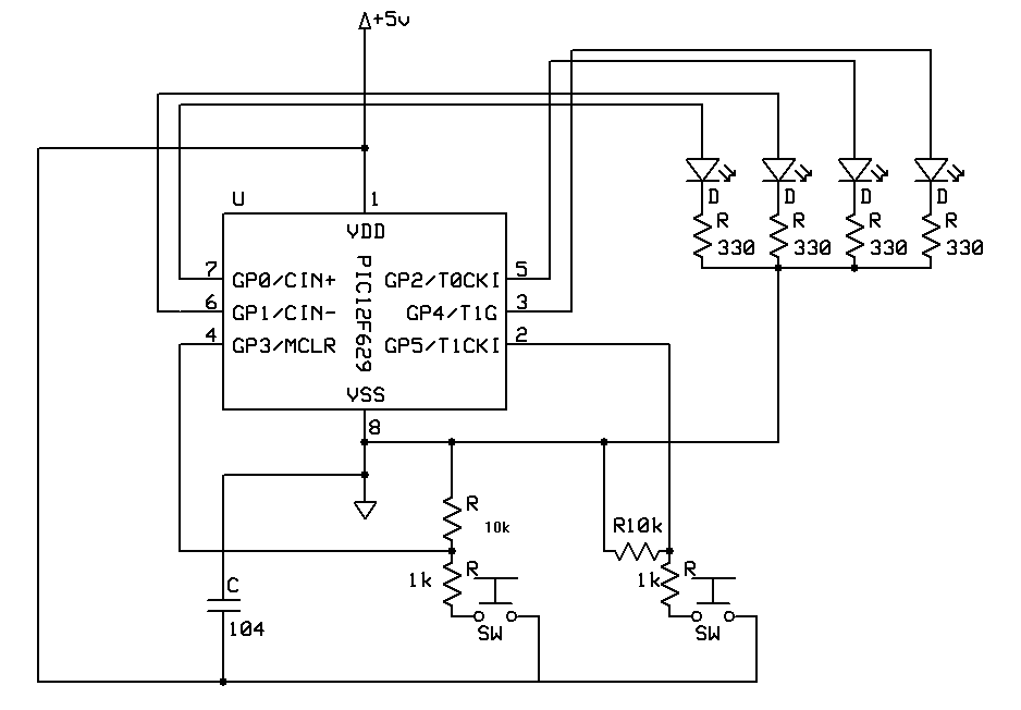

if you draw it out and post we could help you out just the circuit would do.
if you have 7.00 or newer mikrbasic keep it it's better then the pro
I don't no if your setup has mclr pulled up to vdd but if it dos that's why this didn't work

Here is how I hooked it up
Hi Burt,
Yes thats how I had the circuit, apart from the 1k resistors, I assume the switches on the Easypic5 are just grounded or to pos whichever selected? Can't see any resistors in the paths.
I also tried the MCLR pulled high but as you said being on the dev board must have made it error somehow.
Anyway I am just going to draw my circuit out with the new 16F and will post it so you can give any ideas on improvement.
