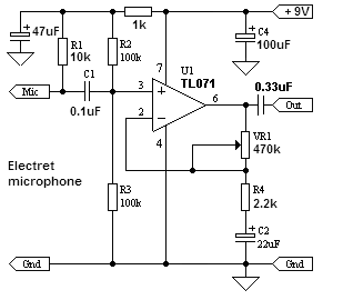

Thanks for the responses. Looks like I will have to order those parts and some others to get it to work. If anybody has a good schematic that uses a TL071 and an electret mic that would be appreciated so I could also order the parts for that.
Here is a preamp for an electret mic. it uses a 470k trimpot to adjust its gain that can be replaced by a fixed 220k, 330k or 470k fixed resistor.
