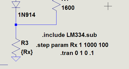

After a closer look on the spec, it seems i got it wrong the first build.
I just tried with the reversed/correct pinout on a fresh LM334, but its still not working.
A dead short between the probes, shows 60mA on my DMM, the last build showed a 140mA
I've installed this LTSpice and replicated my circuit there,
and my simulation is nearly identical to yours.

The LTS sim did show if the series diode was o/c then the current increased, check the diode.
You defined Rx where...?

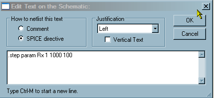

I defined Rx the 'load' as a {Rx} variable in LTS...
I am testing a constant current circuit where I want to vary Rload.
Trying to define Rx as you did, I couldn't find where I have to.
How and where you did?. LTSpice seems very cryptic about it.
Is it a dot command also? If so, it is not in your screen dump.

Its a directive, look at these two images, also added the *.asc file
View attachment LM334b.asc
Thanks Eric. I believed they were brackets, not culy braces. So simple, in front of me.
What a good thing to save time this directive!!
