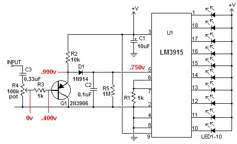

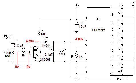

Weird problem myself using the transitorized peak detector.
1st pic- original layout and 7 of 10 LEDs stay lit
2nd pic- transistor reversed and 7 of 10 LEDs stay lit
Perhaps due to the transistor being 20yrs old from RS but they worked perfectly with homemade testor and with DMM readings.
The voltage shows that the transistor has an extremely low current gain probably because its collector and emitter pins are connected backwards.
You know what? You are correct. This circuit has an input of 1.25V to light all the LEDs but the similar circuit in the datasheet has 10V to light all the LEDs. Therefore your LEDs light when the input is only 0.418V.
In my VU meter I use an opamp (like shown in the datasheet) to make the peak detector that does not have this problem.
So, the transistorized schematic is out and the op-amp design is in. thanks
Ps- I was triple checking everything because i though i was doing something wrong too.
I think the transistor peak detector will work with a full-scale input voltage of 1.25V if the diode is replaced by a 2N3904 transistor and the 10k resistor is increased to 100k or more. I'll try it sometime.

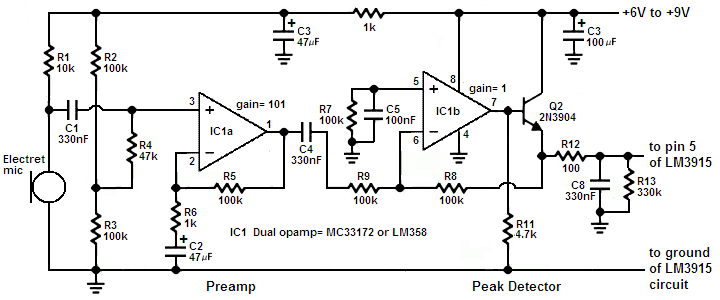

hello, need some advice, what if i try to make the input is from electret mic+lowpass filter+LM3915 VU Meter ? i mean i wanna make a VU Meter for the low frequencies only(100Hz and below may be the voice input) and the scheme in my head is like this :
correct me if i'm wrong, coz i'm in a very need to make a project with this scheme, wanna make the max output(if all LED or only the tenth LED is on = 30dB, and that is gonna be the triggering input for a microcontroller)
sorry, forgot to put a 2,2k Ohm value at the resistor at the positive leg V+ at the microphone.. and sorry for bad english.. :D
The electret mic has an impedance of about 3.3k ohms so it should be powered from a resistor with a higher resistance like 10k ohms. The 10k resistor should have a filtered voltage supply.
Then the mic and the 10k resistor have a combined impedance of 2.5k ohms so the input impedance of the preamp should be 12.5k ohms or more.
But the 2.2k resistor and the extremely low 150 ohms input impedance of your preamp shorts the output of the mic to almost nothing.
C2 shorts the output of the opamp. Do you want a peak detector circuit instead?
In my Sound Level Indicator project I used a dual MC33172 opamp with the first opamp as a preamp with a high input impedance and a gain of 101, and the second opamp as an inverting peak detector circuit with a transistor. You can add a lowpass filter 0.015uf film type capacitor across R5.
oh i see.. thanks, this really give lamp in my head.. i'll try, so, the 0.015uF will be put at R5 output line(going to pin 1) to other side (going to Pin 2) line right ? will make the cutoff frequenciess = 100Hz ?
and can i see how you put the dual op amp, or the single 358 layout ? it kinda hard for me to see how the line will be in the PCB from the scheme(although i really understand how it work now)
If the resistors and 0.015uF capacitor have a tolerance of 5% then the -3dB cutoff frequency is 107Hz. The slope from the simple filter is gradual so that the output is 1/100th (-40dB) at 12kHz. Frequencies above 12kHz will not be reduced more than -40dB.

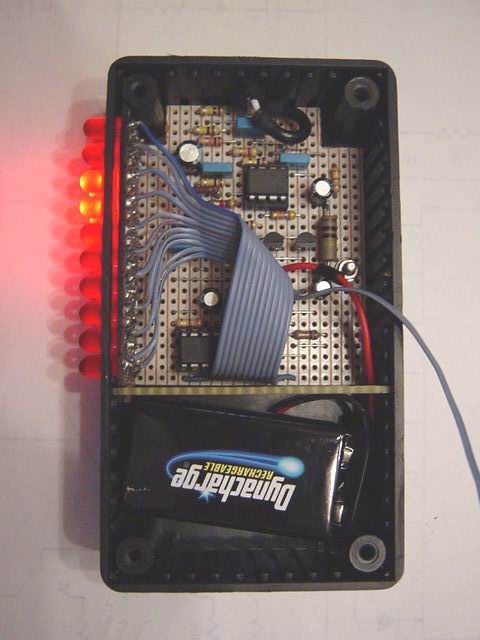

I used stripboard to make my circuit. It looks like this:
