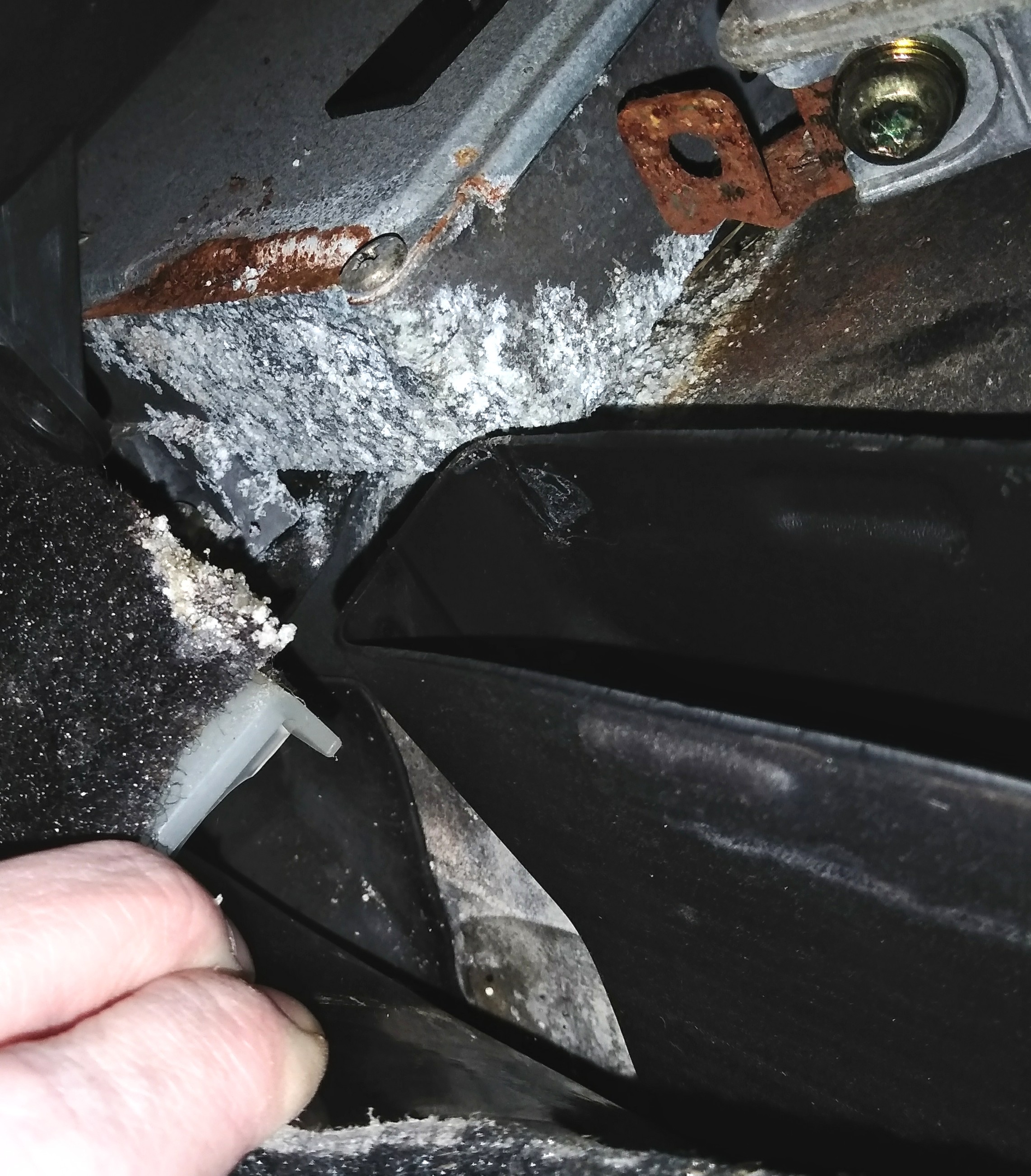

a month after taking my 05 Acura TSX to Dealership for a PCM corrosion recall my car went into limp mode (while it was pouring down rain). the DTC was U0107 (lost communication with TAC module). i followed the factory service manual flow chart & it led me to replace TAC module.. did that..no fix. all the voltage & continuity checks were normal. the only thing left that could be the problem (as far as my knowledge takes me anyway) is the PCM is to blame.
i had removed the interior trim on passenger side to access the PCM connectors but eventually I got frustrated and decided to just pull more trim out.. took out the drivers side to reveal the other side of the PCM & found it insanely corroded!!
when testing some of the PCM pins I had tried to remove all 5 connectors from the PCM but 2 wouldn't budge!
for the recall they were supposed to put a "waterproof" cover on. i found the cheap plastic piece just thrown in the spot where the PCM sits but not covering it at all. after seeing this drivers side angle & the all this corrosion i did a little more research and found out that the PCM was supposed to be removed & the cover bolted back down with a bolt that holds the PCM. I'm guessing the reason it wasn't done in my case could have been due to those connectors being stuck. the only way the mechanics were instructed to actually replace a PCM was if ONE particular DTC was present (that stands for no communication with PCM.. which if a car was driven in there's no way this DTC could have possibly been active!)

You need to remove the pcm.
Inspect the harness connectors for corrosion and repair them if found. If its there, the terminals inside the harness are likely heavily oxidized and may need replacing. They tend to fail mostly where the wire crimps to the terminal, cases like this will lead to confusion a lot of times because when you test at the back of the wire it appears good. When you test at the terminal, its easy to push it enough for the bad joint to connect and appear good so keep that in mind when testing them.
Next open the pcm and see if the corrosion has made its way inside. The unit should be sealed and the pcb covered in conformal coating but honda/acura where a little sloppy about this on older models. If its inside clean it up with some isopropyl alcohol, rework any oxidized components and maybe you will get lucky.
Corrosion/Oxidation has its way of doing odd things. Anything from one problem to many problems. intermittent or consistent. So it's not ludicrous at all.

each wire the service manual said to test (relating to this DTC) were thankfully all located in harnesses that I was able to remove and I did visually inspect the terminals on all 3 harnesses (& PCM plugs) & nothing was corroded. HOWEVER as I mentioned in my previous post there are 2 PCM harnesses that will NOT budge so it's been impossible to remove them!
I realize I really need to get to the PCB inside & inspect it for corrosion.. it's just been something I've put off since those harnesses are stuck & the space where the PCM is located is small & hard to get to (esp with my neck issue).

Since yours is a all in one unit then it makes sense they do not want to handle it under recall. The recall is probably specific to a certain design flaw that always results in failure of the transmission controller. Something like poor soldering of the mcu or a small hole from factory used to inject conformal coatings in the ecu not being sealed properly. So while you may be experiencing issues similar, it still may not be related to the official recall. Keep in mind they will want to cover as little as possible.
