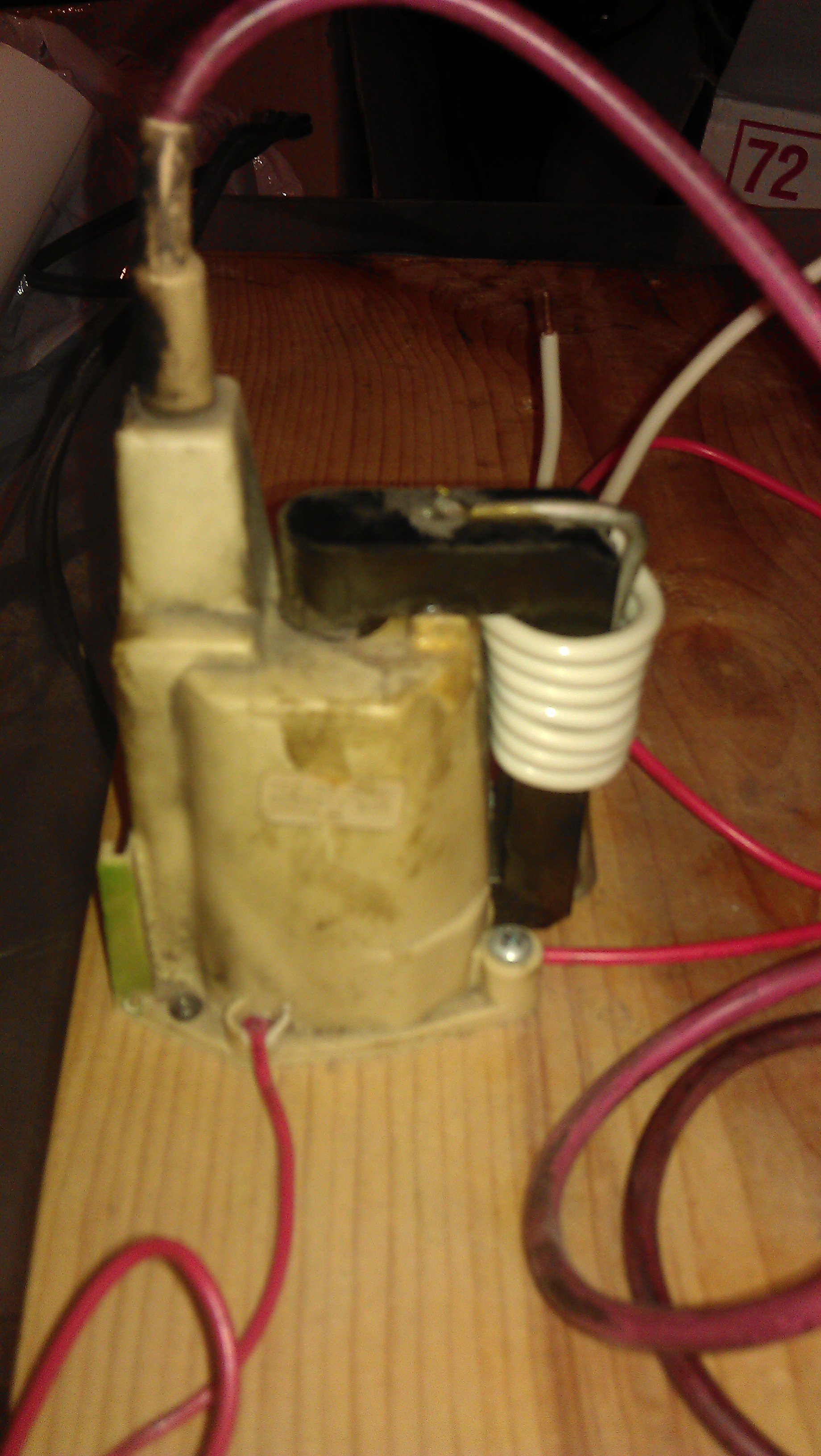

So Im trying to figure out the inductance of the primary of my flyback transformer so that i can calculate its current draw at certain frequencies. Im having trouble doing this. I seem to always get values that are way off the charts when it comes to inductance. does anyone know how to figure out the inductance of this coil on the flyback. there are seven turns of solid wire on the ferrite core which is about 1.1cm by 1.5cm. (its not round its a square core) length of the coil is about 2.5 cm. does anyone know what the inductance of this coil could be. with out measuring it??. I have attached a picture.

So what inductance do you get? What do you think you should get? "Way off the wall" is a little vague.
i would get around 13ooo henrys. which at 30khz and 12 volts would only draw miliamps of current, i know this is wrong because i have had this flyback running before and it draws about 10 to 15 amps.

the gap in the ferrite is 1 millimeter. and i believe the material is manganese zinc.
This transformer looks like a flyback transformer from a television receiver. If so, it will be operating at about 15,70o hertz.
The core material for these devices is invariably similar to the Philips type 3C8 manganese zinc ferrite material. The material is designed for low power loss at a flux change of around 5 tesla.
Any of the ferrite materials suppliers will have a data sheet. Identify the core from its dimensions. The data will give the magnetic properties.
I googled "epcos ferrite" and got started.
You would be looking for "U cores". The core looks like a pair of U cores.

Build a simple resonant oscillator circuit, use a known capacitance across the primary you made about 100nF (use a xrated mains capacitor), then measure the resultant resonant freq, using the freq and the capacitance you can feed these into a lc calculator and work out the inductance.
Note it will change if you load the o/p.
I agree with rumpers on the core material, 3c8 is popular, 5 Tesla's may be possible but only with an air gap, the core material itself will only withstand around 0.25 Tesla.

You could add a resistor in series with the inductor and apply a sine-wave signal. Adjust the frequency until the voltage across the resistance equals the voltage across the inductor so, at that point, the inductive reactance equals the resistance. Knowing the reactance and the frequency you can then calculate the inductance.
A good value for the resistance to use is probably in the neighborhood of a few hundred ohms to a few thousand ohms for typical small inductors.

Also if you were to put a lowvalue resistor inline with the inductance in the final circuit, say 0.1 ohm if the circuit pulls a few amps, you can monitor current into the inductor and see if saturation is occuring, this is the enemy of a switching supply, saturation causes high current drain, and exploded componnets.
