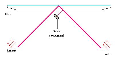

Just in case i wasn't very clear about breaking
the beam into sections,
This is the sort of thing that i have in mind
as 'intermediate' sensors.
Don't know for sure if this arrangement will work,
or function as expected, but i think its workable.

Yep looks fine to me, clever idea. It doesnt take much reflected infrared light for detection by a IR sensor.
Have you experimented with this yet ?
