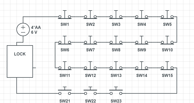

Hi, all, new here and to electronics. I'm looking for help and advice..
I am trying to build a gadget cache for a hobby called Geocaching. This is a hobby where you hide a "cache" (usually a watertight plastic container or an ammo can) in the woods somewhere, post the coordinates online and other people go searching for it using a handheld GPS. The cache usually contains trinkets for trading and a logbook for recording the find. Search on geocaching if you're interested.
The cache will be based on a popular murder mystery board game, where you have to collect evidence to ascertain the correct murderer, weapon, and room. Once you have the information you push the corresponding buttons on the front of the cache and that will activate an electromagnetic lock which reveals a compartment where the logbook will be hidden.

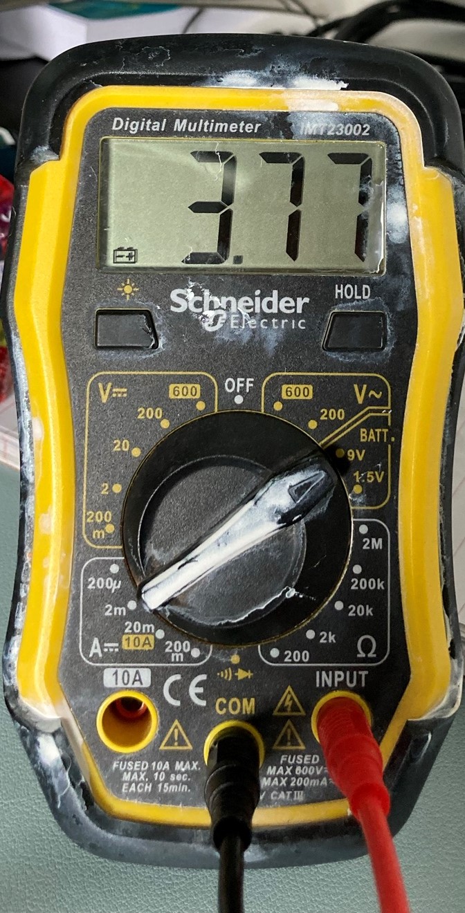

The switch type I selected to use is a NO/NC 5V microswitch. The majority of them are cabled up as NC apart from the correct answers which are cabled as NO. The lock is a 6V 1.5A electromagnet Solenoid Lock. The cable I am using is 22awg stranded wire. I have cabled very similar as the below diagram
When I push the NO switches, to complete the circuit, the lock does not open. I'm only getting 3.77V which is not enough to fire/open the lock. Is this due to voltage drop due to the type of wire that I've used or an incompatibility between the components that I've selected to use?
Any help or advice will be gratefully received.

I can not test the connection from the negative side of the solenoid to the negative side of the battery pack as the lock is a sealed unit with wires. I've attached the negative side directly to the battery pack.
I completed the other tests as you described.
I am getting 5.99v from the battery pack.
I then connected the black meter lead to the negative wire of the solenoid and connected it to every terminal of each switch and only triggering the switches as I came to them. Everything was looking ok until I got to the 17th switch, the third NO switch. As soon as it was triggered, the meter dropped to 4.46v regardless of where I tested along the circuit, which would not trigger the lock.
I then re-cabled the third NO switch to an NC switch. When I triggered the two remaining NO switches the solenoid triggered.

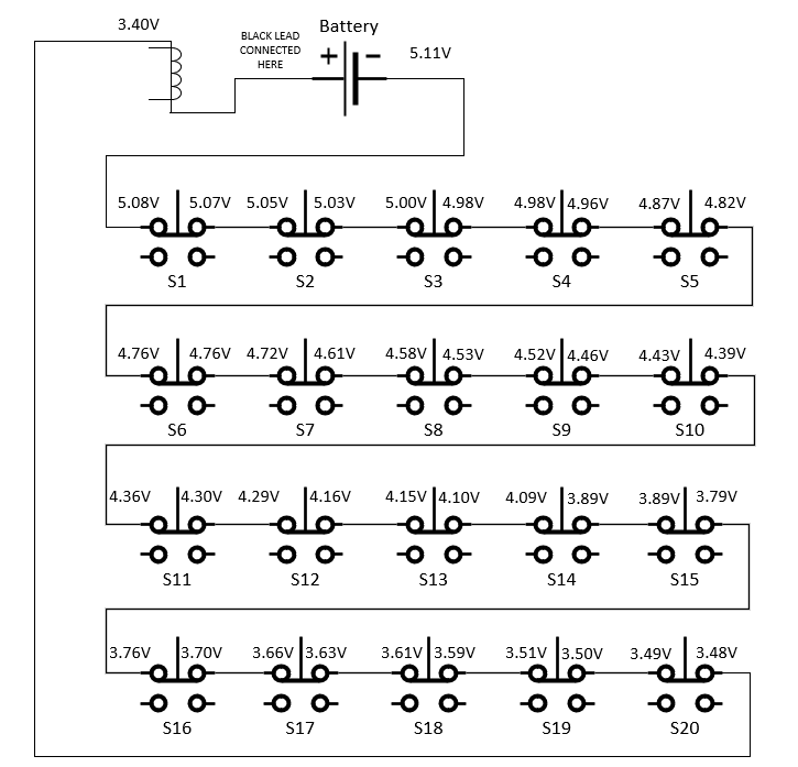

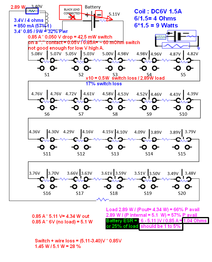

Here are my results, as you said it seems flawed. Am I able to achieve a working design without changing the battery or solenoid choice?
As you can see from the figures, you're making a slight loss in every switch, and also in every piece of wire.

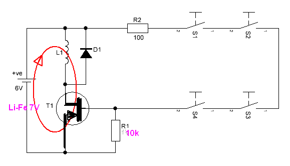

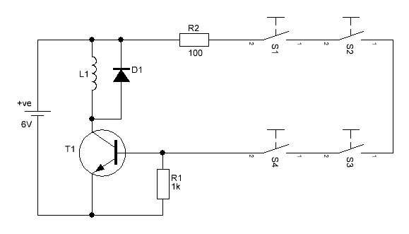

A simple solution would to add a transistor to drive the solenoid, a diode across the solenoid, and a couple of resistors - use short thick wires from battery to transistor to solenoid, and you could still use thin longer wires to the switches. Here's what I'm talking about, you can play with the resistor values (but these should work OK - you want plenty of base drive), for the transistor a small power transistor like a TIP41, and a 1N4001 for the diode.
As I said you want short thick wires between battery, solenoid, and transistor to avoid voltage drop.

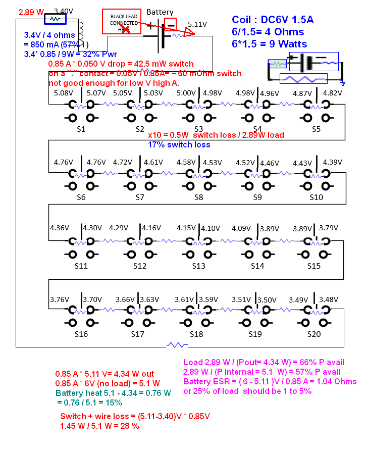

- assuming 4 Ohms I calc'd is correct from website R=V/I here is my quick analysis of where you losses are:
- Pls verify coil ohms , buy FET and move tiny board near solenoid. Make that current loop as SMALL AS POSSIBLE
Battery 25% => Get a bigger pack or LiFe cells
switch and wires 28% => Use Nigel's schematic . Note R2 is 25 x coil R ... Good ratio to use for a big NPN Power Transistor. But you may want a logic level MOSFET.
Your results 53% loss from poor design .
Your goal ought to be < 1% losses in battery, switch and wires. but settle for 5% for cost or heat compromise if absolutely necessary.
Heat = high failure rate
Since power loss is proportional to R. the above means all R's must be < 1% of 4 Ohm load or 40 mOhm max total. so allow 10 mOhm for wire based on AWG and mOhms /m and keep short, move electronics to solenoid. then 30 mOhms max for transistor FET @ Vgs = 4.5V
In future define your 0V point as VBat- not Vbat+ = BLK wire in Common (-) of DMM.
Lithium Cells work best , long life or Li-Ion ,slightly higher voltage. (10%V 20% P)
The tab is also Drain (+) for Nch FET.
$0.57 FET Through hole , works well at 4.5V 9 mohm https://www.digikey.ca/en/products/detail/onsemi/NTD4979N-35G/13439150 in stock
Any 100mA ~ 1 A diode will do for flyback pulse ~ 1.5A 1ms
Bottom Line is Battery needs to be 5x bigger or better minimum preferably 25x better. and you need a transistor switch in a small current loop with battery , coil and transistor.

The TIP41 is about 1/4 Ohm at 1.5A with 150 mA input from 6V which if same batteries is 1 ohm x 4 = 6 Ohms after some aging , means with R2 only provides about 50mA for Ic/Ib= 60 and voltage rises (loss) Vce(sat)= 1V or more. Into the linear region limited to by hFE tolerances. Typically at Vce(sat) Ic/Ib is about = 10% of hFE nominal in the datasheet , but that has a wide tolerance. So it might work for a while or not with better batteries, so R1= 5V/150mA= 33 Ohms would extend use of batteries since it is only used for a short duration but reduce T1 switch losses . So a FET is more desireable and cheap here.

After implementing the design from Nigel Goodwin's message on 15th Sept, it worked flawlessly. I've made a short video of it working and uploaded it to youtube.
