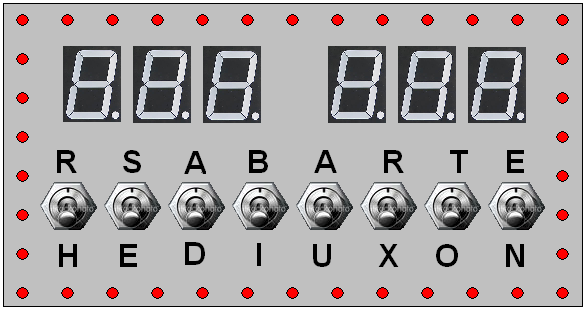

OK, here's what I've currently got in mind. Six 7-segment LED modules. Eight switches. On the panel, on either side of every switch, will be a letter. If they position the switches to spell REDBARON, that will cause the correct coords to display. So if you look at the panel, you would see something like this:
RSABARTE
HEDIUON
where the switches are the "*'s" and the other letters are just random. So the correct switch position would be 1001100, spelling REDBARON. I just made this up; I'd have to come up with some better "wrong" letters so that it wouldn't be so obvious what the right sequence is.
There would be a limit switch on the lid so that the circuit energizes when it is opened.
With the switches in any order other than the correct one, numbers would displayed, but they would be wrong. There would be a ring of LEDs around the display, which would slowly flash red. If the switches are in the correct position, the ring of LEDs would turn green and would travel around the ring (hope you know what I mean--the lights would turn on and off to make it look like they were circling the display) and some sort of "ta-da!" sound would play.
And IDEALLY--after several seconds there would be a deep voice that said something like "place all switches in the down position before closing the box."
So that's where I'm at right now. Definitely not done thinking about it, but that's where I'm at. What do you think?
So something like this is what you're thinking?

Perfect!! Well...almost perfect. I need room for the "given" numbers in the coordinates. Stick-on numbers, same size as the LEDs. For my area, it would look like this:
N 38 33. XXX
W 076 04.XXX
where the X's are the LED displays.
How'd you do that?? It looks great. I would really like to have a nice graphics program. I've been using a student version of Corel 5 that I got years ago, but it's really out of date and I haven't even bothered to try and install it on my new laptop.

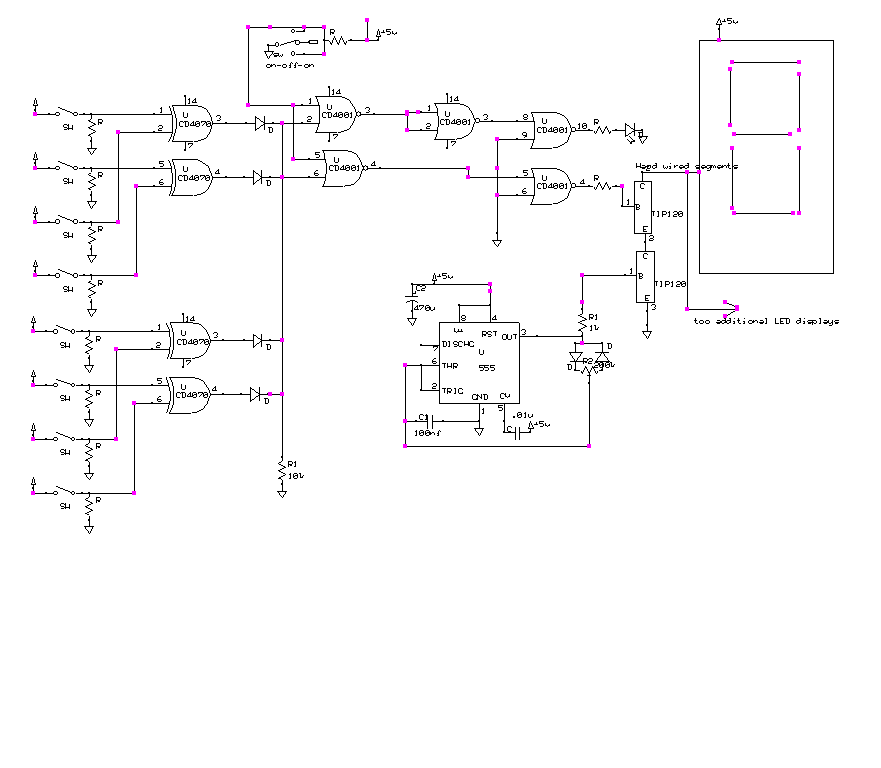

here is an idea I had using an ON/OFF/ON switch.
every time you open the lid the code is changed from sat 1001 to 0110 etc.
the idea of a PIC is perhaps your best bet but don't have more than 3 or four combos.
may be too frustrating.
in my circuit it has only two different correct answers depending on the lid opening switch which is an ON/OFF/ON.
the 7555 is for PWM (conserve battery life)
the RED LED indcates a wrong answer.
the LED displays are hard wired to each desired segment so when you get a correct code entry the LED displays light up.
circuit needs work but it could be a basis for your project.
