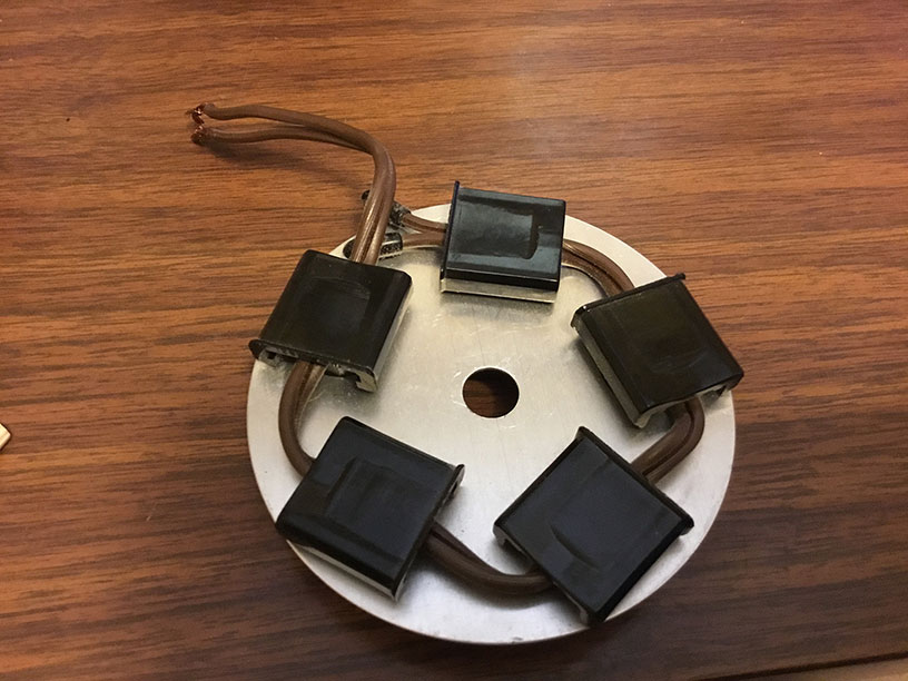

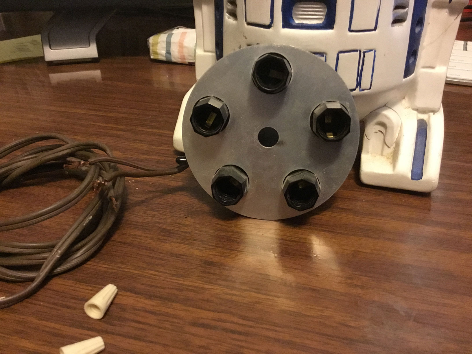

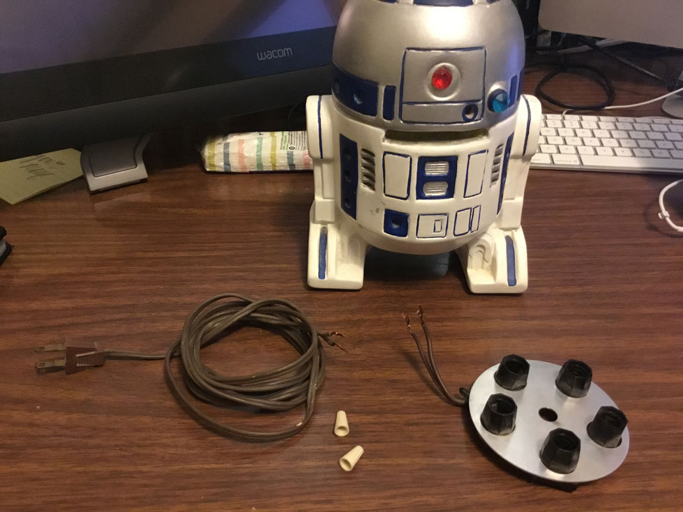

Second, I have something I'd like to fix. It was a simple light fixture that used edison bulbs inside an R2-D2 ceramic model. This was made in 1978. The fixture worked until a week ago. For years, I realized even without electrical expertise, that a cord like this with this set up would not likely work for 40 years, but it did. The fixture simply stopped working when plugged in. There are small burns at the cord ties.
I have three pictures here to show. My main question is whether the fixture is jury rigged or is it an assembly that can be purchased? Either way, I was hoping to get opinions on a modern alternative. I would like to note that these edison bulb fixtures allowed for the lights to turn on and off. It would take maybe 2-3 minutes to warm up and then the sequence would start. I want to say two lights would activate for about a minute or two then turn off and two others would then turn on, etc.

rjenkinsgb Actually what you see there in the pictures is all there is. The cord ends tied into the fixture unit with those wire nuts. The fixture is then screwed into the back of the model and sat vertically on the inside. The screw allowed it to hang there. The model has glass elements and holes that allows the light to shine through. The cord on the fixture unit does seem to match the cord with the outlet plug. The fixtures are part of the cord and do have two capped terminal ends.

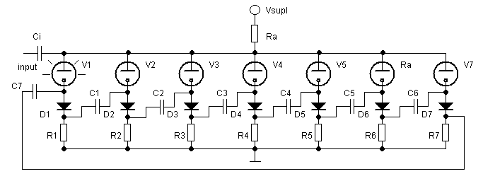

A line-powered neon sequencer requires at least a half-wave rectifier in series with the cirucit. The caps then can be electrolytic if needed for long delay times.

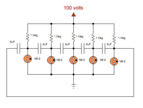

Here is one version. The 100 V is DC:
118964
Here's another, sequential flavor:
118965

Those are simple insulation-displacement sockets, with no brains inside. The big squares on the bottom slide off to reveal the contacts. Sliding on the cap presses the wires down into the tines to puncture the insulation. You can slide off all of the covers to confirm, but I agree with others that the five sockets probably are in direct parallel, and all light control is built into the bulbs.

If all of the lamps died at the same time, the wire under the wire nut may have simply oxidized and current flow slowed over the past 40 years. As resistance of the connection goes higher, so does temp and it eventually the heat, oxygen combination eventually oxides all the wire surface and it crapped out.
Try getting s new extension cord at the hardware store of the same thickness and wire gauge. Then open each black box and remove the cords without bending any of the small pins that are puncturing the cord insulation to make contact.
Then install the new section of cord by positioning it carefully between the two halves of each box and tightening the screws. The pins will either puncture the insulation or slice into the insulation.
That main power source is the only thing that would cause all to die at the same time.
If they stopped working one-by-one over the years, there is likely just an electrical contact issue at each box where the cord connects.
