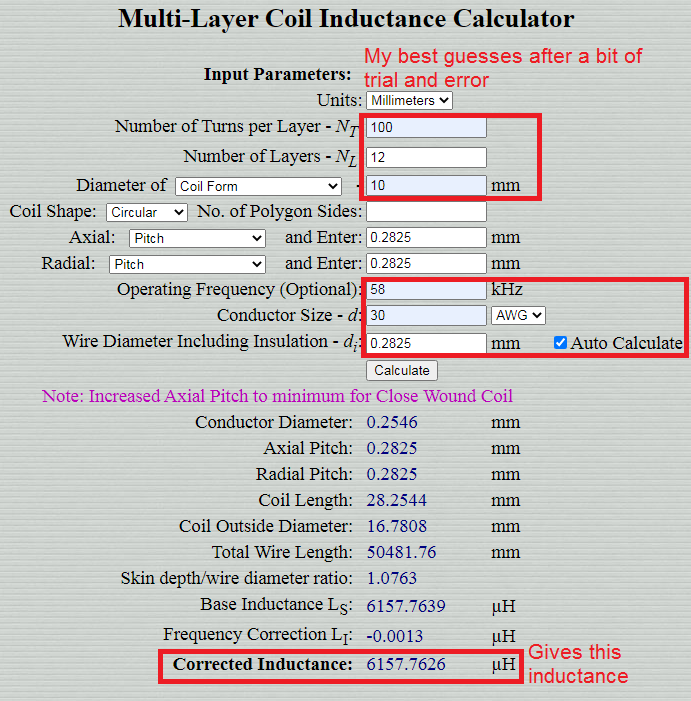

Its definitely going to be a thick coil with 1,200 turns on a 10 x 100mm ferrite rod

1200 turns with 1mm dia wire will be enormous.

I had a play with the calculator, and after a bit of trial and error, I got this:
1200 turns of 30AWG wire, in 12 layers on a 10mm former gives 6.157mH
But we wanted 9.47mH the crowd shouted...
The calculation is for an air-cored coil.
When we put the coil on to a ferrite core, the inductance will double (or maybe more).
Actually the inductance will vary depending on the position of the coil on the rod, more inductance with the core in the middle of the rod, less inductance with the coil at the end of the rod.

Hi, I made the coil today and it works quite well except that it doesnt have much range.
if I upped the volts would that give it a little bit more range?

a coil on a linear form is not going to have much range. if you might have noticed, the coils in the store are in containers that are 3ft high x 2ft wide x 4 inches deep... the coils are "pancake" coils where it's on a flat surface and one end of the coil is at the center, and is laid down in a spiral and the other end of the coil is at the outside... very similar to the antenna coils of the RFID tags

Hi, It is not my point to create a huge coil like the stores use.
I wanted to create a jamming device for that frequency and I was able to.
I upped the voltage and it gave me the results I needed.
