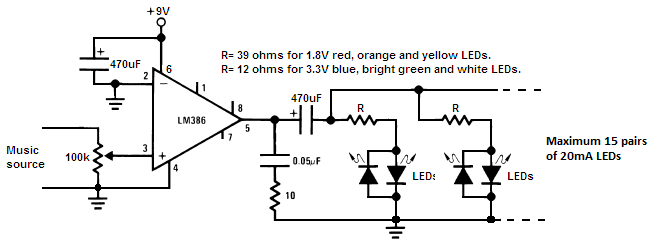

A Joule Thief circuit dimly and continuously lights an LED from a single battery cell that is almost dead. It cannot be blinked with music.
An LM386 audio power amplifier IC can amplify the audio and drive up to 15 pairs of LEDs at 20mA each from a 9VDC power supply. Here is a very simple circuit that blinks the LEDs to the loudest sounds of music and speech:

well, what i wanted to know is, if it is possible to run just 2 LEDs through the power that is provied by the speaker and microphone line of an iphone?
because the microphone lie supply 2v to microphones over 1600 ohm. blinking or not doesn't really matter at this point, as long as i can get a prototype working.
with a rectifier i simply "flip" one side of the wave, is there a way to "push" to wave to one polarity, so you still have the wave sine?
Best regards, Michael
Simple answer: No. Not without an external power supply.

The circuit I posted needs a few changes to light 3.5V blue LEDs from a 7.2V battery that drops to 6.4V per charge.
