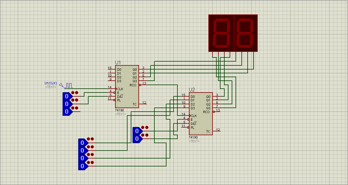

Hi.I have a same problem.i use 74190 and it goes to 99.how can i change it?59>>00

you have to make a logic high when logic state of 2nd counter just changing to 6 and connect it to reset both counters, you may need to use few AND / NAND gates to get logic high for reset.
thanks.I try that before i write the first post.i Use nand gate.when Q1 and Q2 turns to 1 (0110=6) Nand gate turns to 0 and left 7seg must turn to 0(if pl=0 then 7seg resets).But when number turns 3 to 4 nand gate recognize that both of the pins are 1 and resets the segment (1100--->0010)

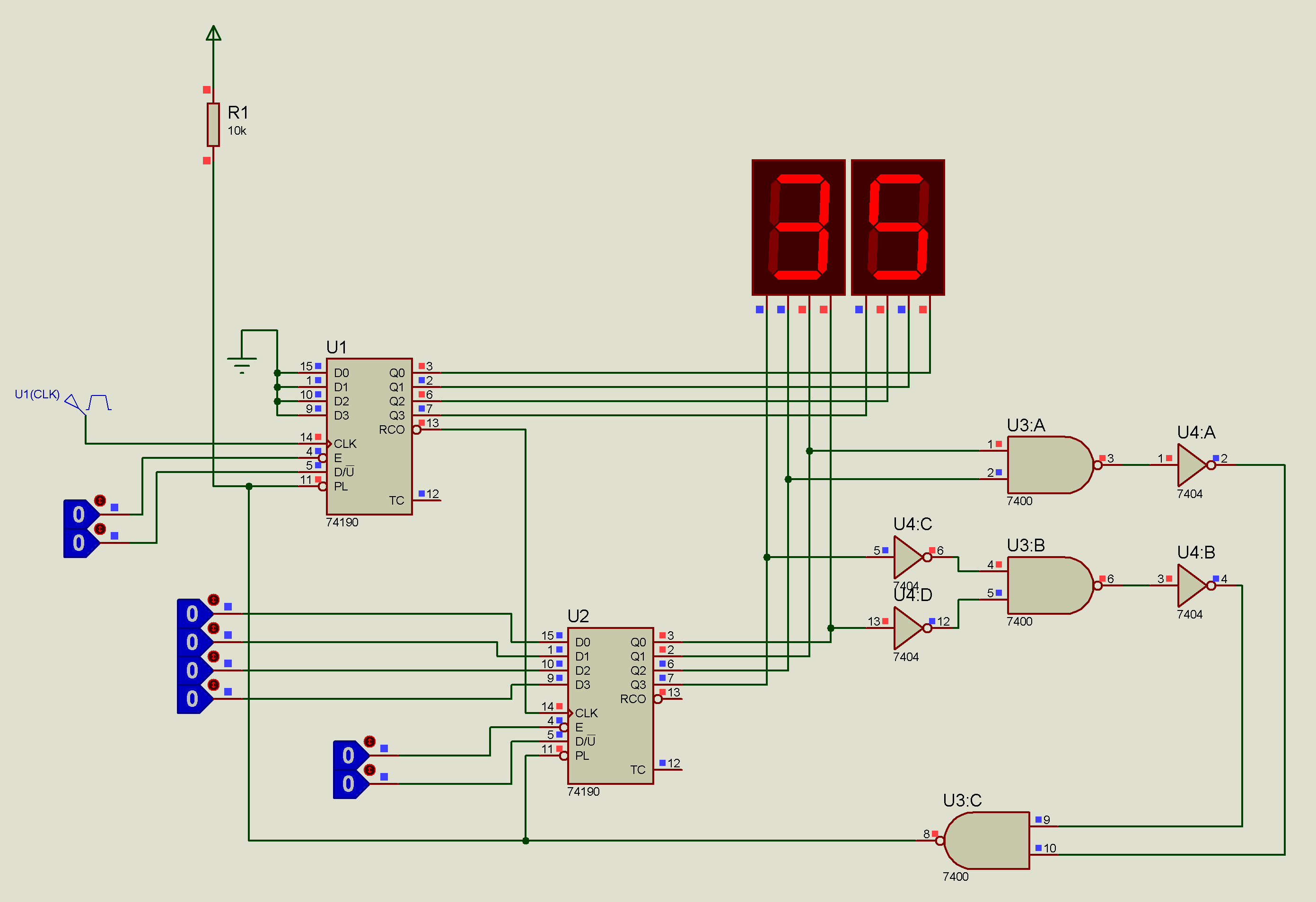

What if you do it like this.
you must consider all four digits to get reset out, say if ABCD= 0110 then the combination must be A^BCD^ , similar to what absf posted.
