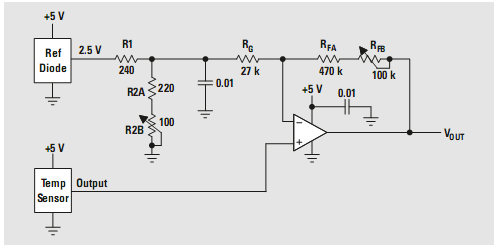

Provided the sensors zero value settles, then i thought of adding a SET-ZERO & SET-SPAN analog front end to the XTR111 as shown below
Source : TI Application Note SLYT015
The gain in my case would be very small, close to 1.5 (not as shown in the app note)
R2B sets ZERO and RFB sets SPAN
In my OP i have mentioned of the existing procedure for one of the manufacturers.Is it on the same lines?
I thought i would require a rail-to-rail opamp and found the AD8541 and am building the schematic around it.
Am i on the right track?

You'll never calibrate at full span. In a system i created once that involved calibration, I used "Nominal" values and a "multiplier". So if the output was supposed to be 0-5, I used 5. then had a multiplier of say 1.012 In another system, I switched in a 5V reference to set Full scale. That full scale value was real close. real calibrations could later nail it.
2)The XTR111 needs a range from 1v-5vdc to convert to 4-20mA out.
5V = 20 mA will be IMPOSSIBLE to achieve with a 5V supply. Single supply OP amps have a LOT of nuances to deal with.
You may find that the sensor really is current out. I can't tell from the datasheet. So the load resistor can be at the measurement side and the 5V supply at the sensor.
The +-0.1V may mean that a simple 5V 3-terminal regulator won;t work.
The mounting of the sensor might be critical as well. e.g. if your using clip leads now. The leads will probably need to be a thermal sink.
It looks like for really accurate readings, you would want a temperature/humidity sensor at the sensor as well.

Hello
I guess you are right. The opamp is not a true rail to rail device.
The 5V reference will be created by the XTR111 , and it is fairly stable
Vreg output :
vs temp : 30ppm/°C
vs supply : 0.1mV/V
Effectively a 4.8v would be output at the Vin at XTR111? Is that what you are saying?
Which would mean that i would need to set a Vcc >5v at the opamp?
I am supplying XTR111 with 24Vdc and the 1-5v is the input to Vin pin, which converts to an equivalent 4-20mA.
The Load resistor is of course at the receiver side.
If you want a 4.8V/5V output from the opamp shown in post #3, even if it's nominally rail-to-rail, I'd suggest a +ve supply >5V. You have 24V available, so that (or a regulated lower voltage derived from it) would do.
Yep. Also look at the range of the inputs and outputs. You might look at the "Over the top" OP Ap series from Linear Technology too. They will not die if the inputs drastically exceed the supply voltage.
