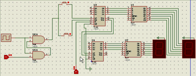

I found this schematic, do you think this will work?
We're getting closer, good.
But dude, that's way too small for me to see what's really happening. In principle some of the scheme looks fine, but the devil's in the details, which no person could possibly parse at this magnification. Please post the source URL for your diagram.
In your little drawing, it looks like an astable oscillator is providing pulses to the counter via two pushbuttons, up and down. That's a bad way to go for several reasons, 1) the switches will bounce causing your count to be all over the place, and 2) depending on when the user hits the switch the clock edge could be at a bad place, again causing a weird count. Plus I can't tell what the two NAND gates between the clock and pushbuttons are supposed to be doing; it looks like gibberish...

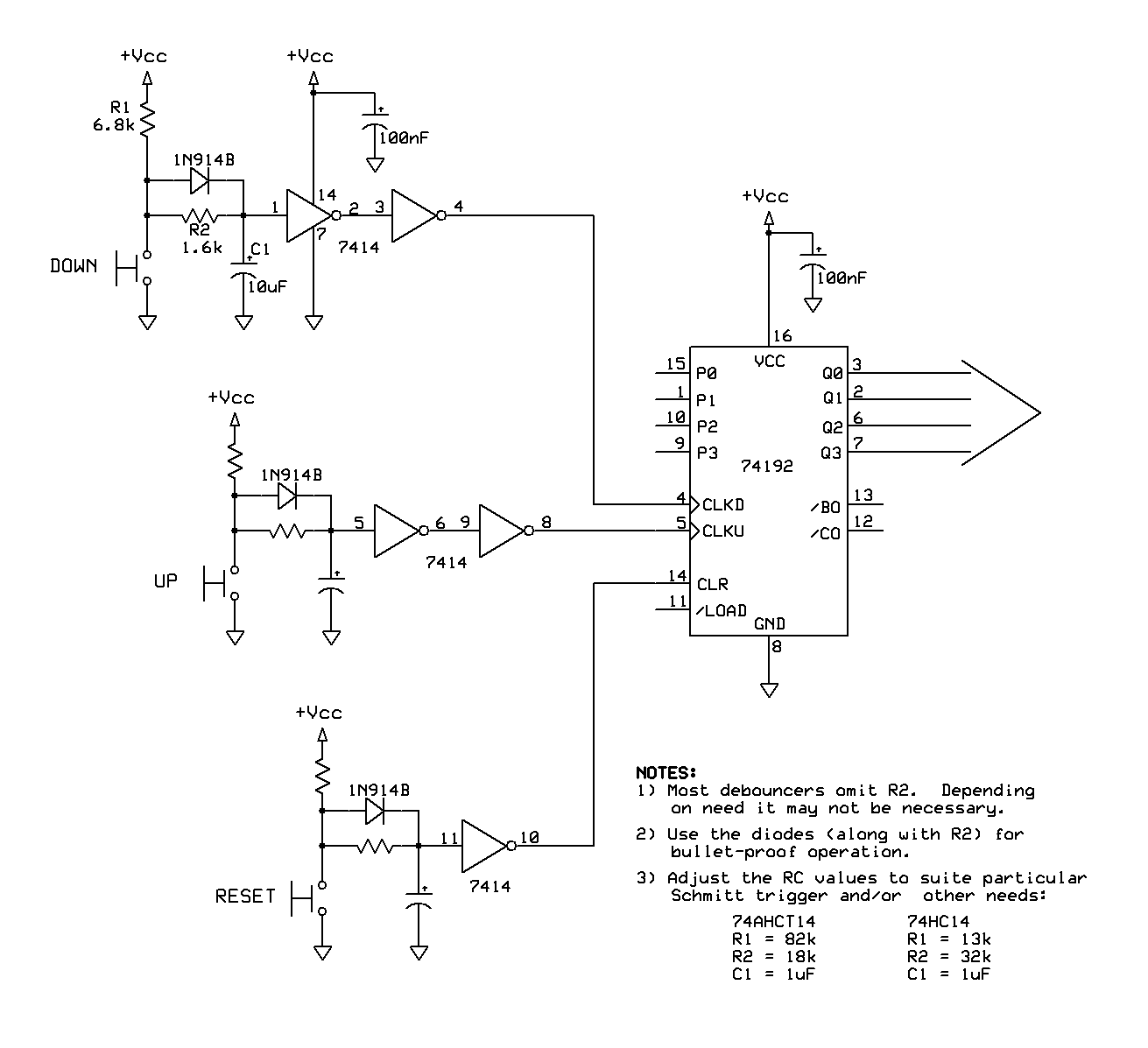

Try this, it should get you started:

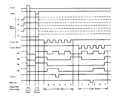

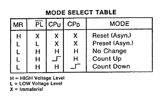

hi Corey,
Dosn't the 'unused' clock input on a LS192 have to be High while the 'other' clock is pulsed Low, in order for it to register the low going pulse.?
Hey Eric,
Good catch. Yes, after taking a second look, the unused input must be held high. He'll need a second inverter on each of the counting inputs.
EDIT: Eric also kindly pointed out that the original R values were good for a CMOS Schmitt Trigger, but wouldn't let the input get to a valid low for the TTL part. Try the new RC values as posted in the updated drawing above. If you're using R2, it's calculated for proper timing AND typical Vt- (900mV), but may need to be bumped down yet further to accomodate worst case Vt- (600mV), say to 1.1k (600mV/560uA=1.1k)

That drawing was updated recently to alter the RC values, it also added a second inverter to each up/down input. Your circuit is wired that way, i.e. according to the updated drawing? Double check it...
