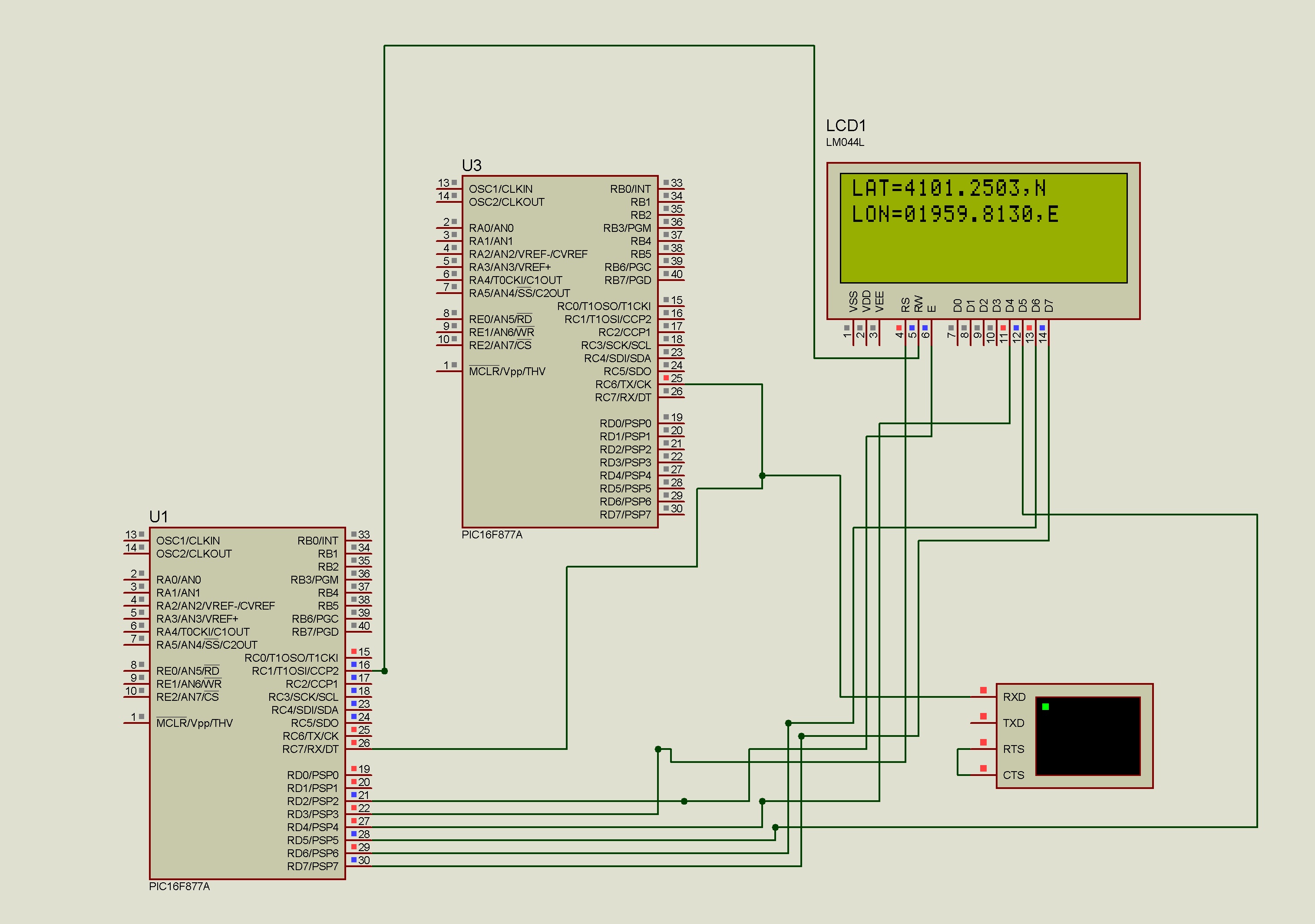

here is my code it extract latt/longi first time only but when program executes 2nd time it stuck at serial() function and do not return to the main :(
i am using CCs compiler.
thankss ..

Your serial isn't getting 'L' and 'L' .. Heres what to do... you make a 50 character buffer.. you read the serial port and place the byte in the buffer and continue IF you receive an 'L' you mark its position with a pointer IF the next char is an 'L' you then count 25 each time there was a received character... you poll the serial port using the RXSTA.RCIF.
well as i am new to programing i dont know how to locate 'L' through IF and when program run 1st time it sucessfully gets "L" from rx so what happen next time?
This is why it only works one time A while loop will only run while true your making it false with this "for(loop;loop<25;loop++)" It can't inc past 25
Should be " for (loop=0; loop<25; loop++)"

Check this out:

This is untested since i dont know exactly what you need.
What is the data your expecting i mean? From what i can see. You are expecting 24 bytes..
First byte is "L"
Next 11 bytes is longitude data
Next byte is?
Next 11 bytes is latitude data
Am i correct?
Did u test my code?
