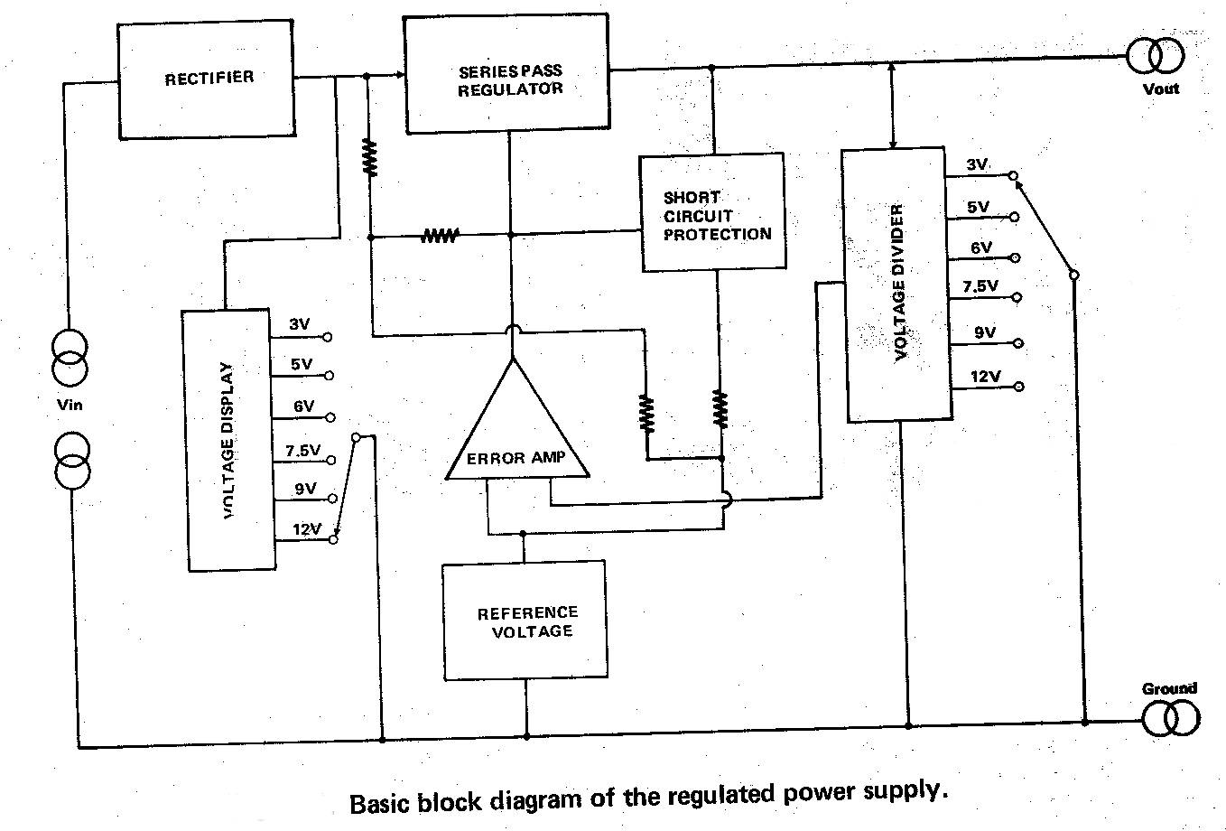

Here's what you want a transistorized regulated power supply.
I'll post soon the parts list if this circuit helps.
note: voltage display (error) reverse the switch.
voltage display corresponding in voltage divider.
It's rather crude, and only slightly regulated - using a couple of foward biased silicon diodes as a reference doesn't make for good regulation.

The base-emitter junction of Q2 will break down for output voltages above about 7.5V (assuming 6V breakdown voltage). This will degrade the beta of Q2 over time, and will also increase the current through your reference diodes (D2, D3) and cause the output voltage to be somewhat higher as a result.
The temperature coefficient of your reference is about -6mv per degree C (D2 & D3 plus Q4 Vbe), which is not a problem if the ambient temperature is relatively constant (and you don't have the diodes or Q4 mounted close to Q1). If they do drift, the tempco of the output is multiplied by the feedback ratio. For example, on the 12V setting, the output tempco will be about -40mv per deg. C.
Transistor Q1 is the series-pass transistor;Q3 is a darlington configuration. This improves the response of Q1 with respect to the error signal. Transistor Q4 acts as a comparator or a differential voltage amplifier. D2 and D3 are silicon diodes in forward biased connection. Q4 and R4 supply enough current to the diodes and maintain an almost contant voltage drop of about 1.4 volts, the reference voltage. Capacitor C3 provides pre-regulation to the comparator circuit. The base of Q4 is connected to the voltage-dividing network of R6 and R7 and the combination of R7 with any or all of resistor R8to R12 Any change of the output voltage appearing at the top of the voltage divider is sensed at the base of Q4 and afterwards amplified. This results to the error or control signal at the base of Q3 and the series-pass transistor Q1 responds immediately by changing its conduction to maintain the desired output voltage.
An increase in output voltage will be feedback to the base of Q4 which, in turn conduct more current. This reduces the drive to the load, effectively reducing the output voltage. The reverse will happen when the output voltage decreases. Thus, the output voltage is properly regulated
I agree that it's well-regulated. It just has a crappy tempco, and a short-circuit protection transistor which is operating with the b-e junction in avalanche.
A short circuit protection is a current-limiting with foldback type. Foldback is desirable since the short circuit power dissipation of the series-pass transistor Q1 can be limited, preventing damage to it. The emitter of Q2 is connected to the output which effectively reverse biases transistor Q2. If the negative and positive output terminals are accidentally short circuited, the emitter of Q2 will be grounded. Current flowing through R2,R4< and R5 will force saturation, thereby limiting the current to almost zero. On the other hand, when the short circuit is removed, the output voltage will be back again since Q2 becomes reverse biased again.
The problem is, when the Q2 emitter is at, say, +12V, and the base is connected to the reference diodes through R5, the base-emitter will potentially have about 10.6V reverse bias across it. Look up the breakdown voltage spec on Q2. I doubt that it is more than 6V. This means that the reverse current flows through the junction, which will degrade beta over time. Depending on the value of R5, the degradation may occur slowly. Still, it is not a good design from an engineering standpoint.
The first thing I was told at my first job (at Philips) was to never allow an emitter-base junction to have avalanche breakdown.

Will the circuit work satisfactorily by adding the following changes:
1. extra diode(in4001) in the base connection of short circuit protection transistor Q2.
2. add one more diode in series to existing diodes(reference) or replace the three diodes using a 2.5V reference like LM336
3. recalculate the output voltage divider
4. forget the above and just use a three terminal regulator like LM317 or its higher current brothers
