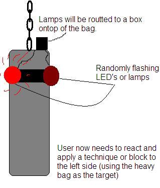

Well, I don't know to much about electronics, and only really need to learn a little bit to create this project I'm working on.
I'm trying to create a punching bag "Add-On" that has two lamps that light on randomly, but only one at any given time. The purpose is to allow me to practice some self defense techniques using the lamps to represent which side the attacker is comming from.
I did research on this, and came up with the 555, and playing around with it, I can not produce the random results I'm trying to achieve, which brings me to believe that I need another chip.
I need it to reset about every 3 seconds, and stay on for about 1 or 2 seconds (otherwise I wouldn't be able to tell if one lamp or LED stayed on for two "turns".)
Any help or direction would be greatly appreciated! :D

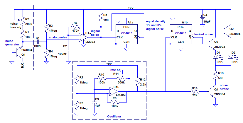

Flyingmonkeyc, here's a circuit for you. I breadboarded it, and it works well.
To test it, you might want to speed it up by temporarily changing C3 to 100nF.

I think the randomness of that circuit depends on the 1uF capacitor charging to a different voltage each time the pads are touched (due to the amount of time touched, skin resistance variation, 50 or 60 Hz noise added, etc.). If you just short the contacts permanently, I doubt that it would be as random. Perhaps the fact that the BC557 in the timer doesn't saturate would add some randomness.
It took me a couple tries, as I'm still new at this, but I finally got Ron H's circuit to work perfectly, I added a POT to it, and an On/Off switch, though it took me some time to add the POT so it worked nicely...I'm now soldering everything together...thank you Ron H and everyone else!!!
