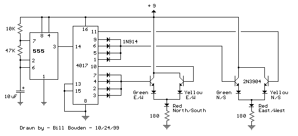

Hi. Currently i have to do a microp 8085 project. so i select to do a traffic controller circuit using 8085. Actually i try to start from basic so i found "THIS" diagram from website and upload it in attachment.My question is
- is it i have to add IC other than 8085 microp to make sure it function such as eeprom IC?
-what is the simple method that can be apply to edit the circuit that i upload?
- OR this circuit totally have to change if want use 8085 on it.
Thanks.

Kind of a strange circuit. You will always have the RED led lit if you light a GREEN or AMBER LED.
PS use a micro that can drive LEDs directly, like a PIC or ATMEL.
Yes.... Just like a real traffic light. When the East/West traffic light is yellow or Green, the North/South traffic light is red...etc....

In Canada we have double red in both directions for a moment.
I've often wondered WHY we have that since most people are asleep at the light and do not wakeup until it's been green for 2-3 seconds anyway.
