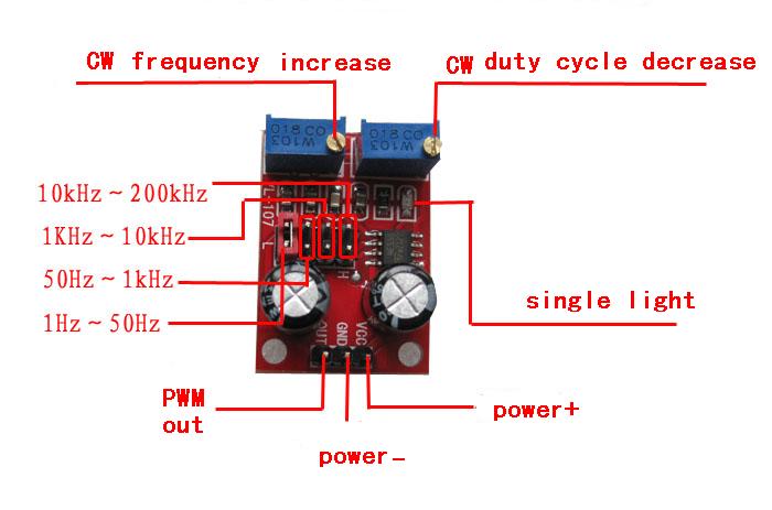

Black to Yellow with flowmeter unplugged and alarm sounding it is fluctuating wildly between zero and 4.95 Volts but if I press the reset button it then cancels the alarm for a few seconds and the voltage is rock steady at 4.95 Volts ,I have connected the pulse generator with Red to VCC Black to GND and Yellow to OUT and the LED pulses but only at about 1 pulse per second which I believe would represnt too low a flow and sound the alarm which it does , I have tried moving the jumper from it's as supplied position which is closest to the edge of the PCB one poition further in towards the centre of the PCB one place at a time until I reached the last position but things only seemed to get worse , I have not touched either of the 2 variable Resistors as to be honest I have'nt a clue as to whether to adjust one or both and by how much ? , I am also wondering if the fact that during these tests the White wire being connected to nothing is in itself causing the unit to alarm ?.
Note that you have jumpers that select the range.
The potentioneters are likely 10 turns ad will start to "click" at their stops.
The pot labeled CW duty cycle decrease, means when you turn it left, the on time of the LED will decrease. e.g. from 1 sec on to 1 sec off to 0.5 s on to 1.5 sec off.
Similarly the "CW frequency increase" will increase the frequency when turned clockwise from 1 to 50 Hz, if on that range.
The jumpers will just make the LED on steady and probably decrease the brightness, because your eye can't see the changes.

Ok i'll have a play around with it and see what adjusting the cw frequency does but it still does'nt help me in knowing what to do with the White wire ?.

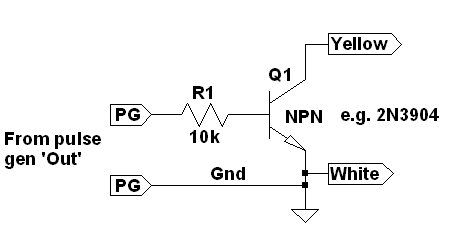

The manual for that Koolance model is here. It is clear the the yellow and white wires have no sensor-produced voltage on them and are simply for the two contacts of a normally-open reed switch. The red and black are respectively the + and - connections for the LED supply (which you presumably will be using instead to power the pulse generator; red to Vcc and black to ground).
So here's how you could try interfacing the pulse generator output to the cooler input :-
Note that the white wire is grounded here. Both yellow and white need to connect to the cooler input.
Q1 acts like the reed switch (which the manual actually refers to also as 'open collector').
Depending on the cooler input circuitry, connecting the pulse generator 'Out' terminal directly to the cooler input, as you did, may have made it unhappy, because the generator is based on a 555 circuit which actively pulls 'Out' high.
Ah that's interesting i'm not familiar with reed switches very much but guess that the magnet on the Impellor opens and closes it as it passes , i'm not very good with electronic schematics so will try and brush up on it a bit in order to fully understand the connections I will need to make .
The manual states "The Koolance INS-FM16 uses a magnetic reed
contact switch (open collector)". The options are very different, but generally compatible. I picked a smaller resistor from (4.88-0.6)/10e-3).
