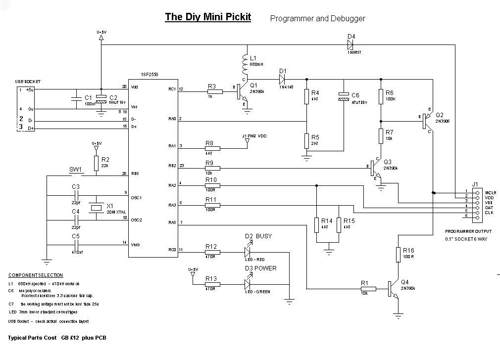

If Winpic doesn't support it then do yourself a favour and get a PicKit3 so you can debug as well. They can be had on ebay for under $15 For Example.
A long time since I used WinPic but seem sure I programmed my 18F4520 chips on it, which fit your requirements and more.
The 18F range has the advantage of easier memory usage and extra features over the older 16F chips; makes Assembly coding a lot easier.
Agree with Pommie a Pk3 or even the trusty old Pic2 should be a worthwhile purchase, Microchip or Far East clone, or even DIY if you search this forum many plans for a Pickit2 - Search 'BlueRoom' and ' Pickit2'
