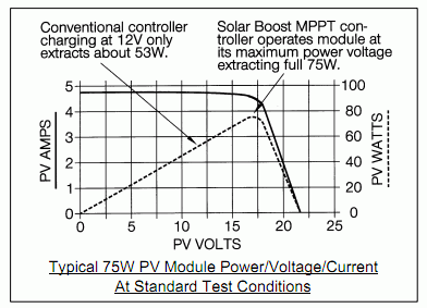

But as far as electronic definitions are concerned, "(Maximum) Power Point Tracking" means
the tracking of the best use of supply potential differential (V) to Maximum flow available (I)
to feed a (usually) mis-matched end usage load to maximize THROUGHPUT between the two.
Sadly, this complies better to a grid-tie feedback ratio,
than it does for solar collection and storage for later use.
Often, in the case of solar, to favor the highest charge storage ratio for later usage,
as to the opposing the optimum "Power Point" charge ratio method of storage stratigy,
is hampered by the lack of a crystal ball to optimize the charge method to use that day.

the maximum power it can deliver depend on two things,
the temperature of the panel and its position to the sun.
Well, I'll give you that one, as two of the top five...
