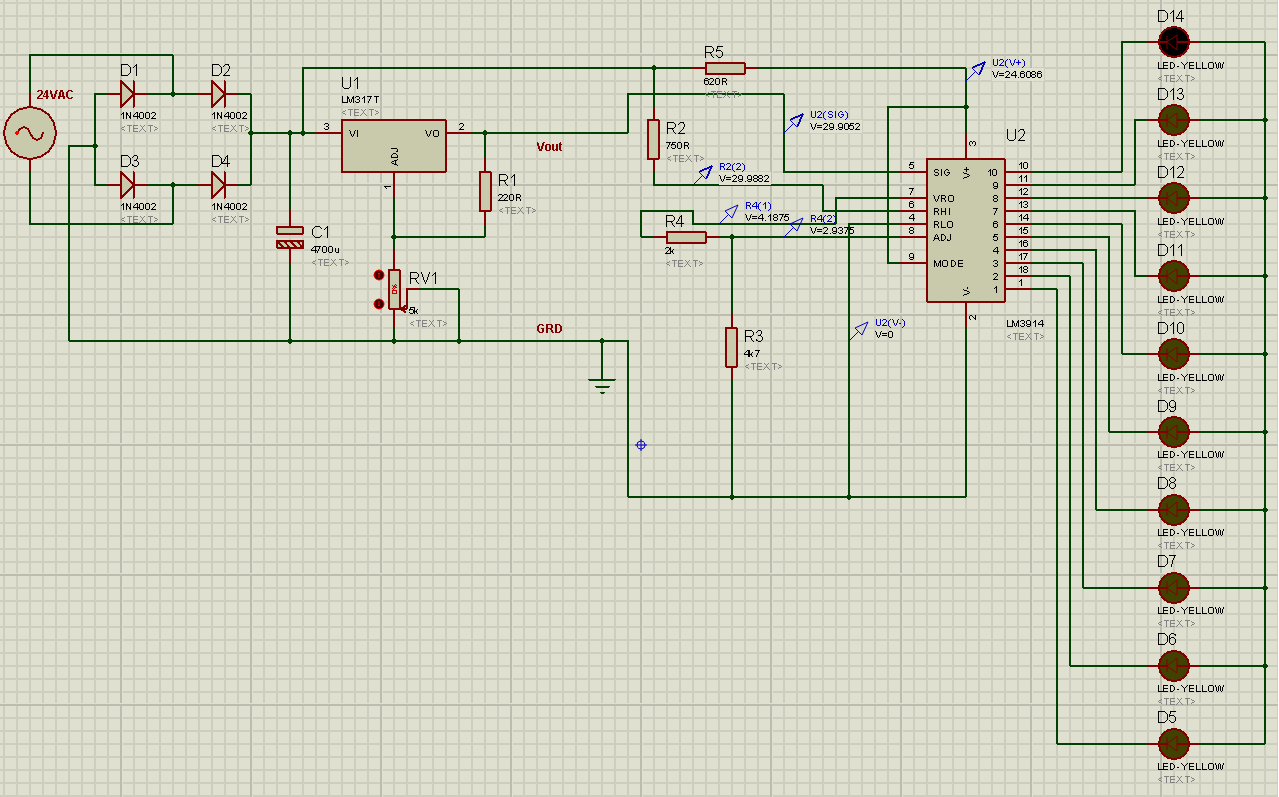

Please FIX my design
Here is my designed circuit after using the simulation for lm3914. When im using bargraph mode, the 10 LED are not working perfectly working. The LEDs are mostly dim. Please see my attachment.
What's wrong with my circuit?

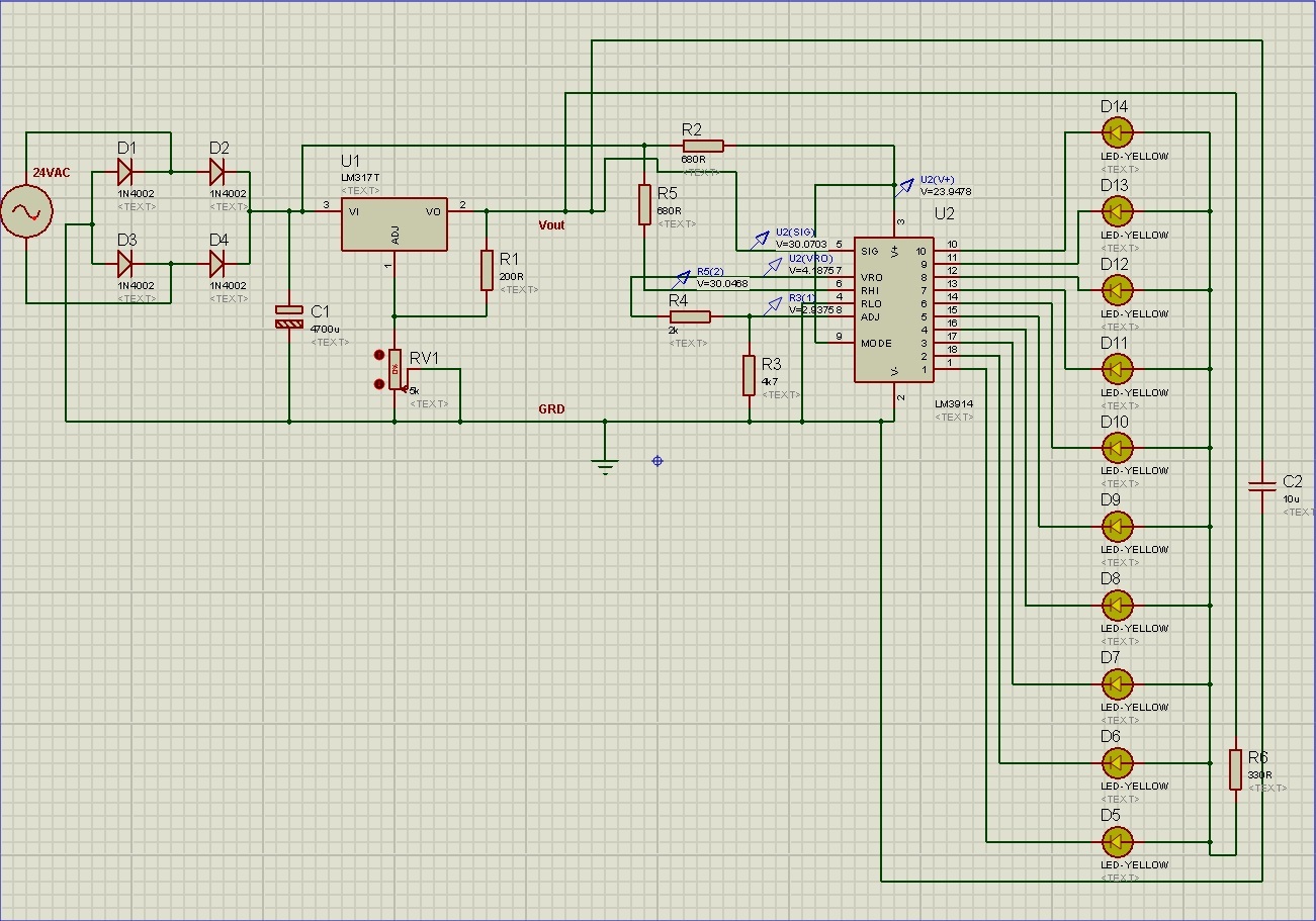

Please check my circuit design.
To those who helped me, thank you so much. I've come up to this circuit design and it running in my proteus. But i would like to ask for you spare time to check my design. Here it is.
I need to transfer this in pcb as soon as possible because the submission of this is nearly approaching.
Thank you so much.

That circuit is NOT suitable, there is NO mains transformer shown, also there are errors in the remainder of the circuit.
You require an mains isolated power supply that can supply a DC voltage at 0.25A , the DC voltage of the supply can be from 9V to 20V.
Let me know which power supply you have available and will post a circuit diagram.
If you rectify and smooth 24Vac you will have a DC voltage of 35Vdc, the LM3914, is rated at 25Vdc max.

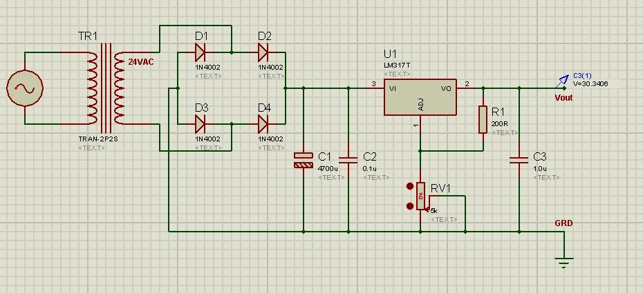

Here is my power supply.

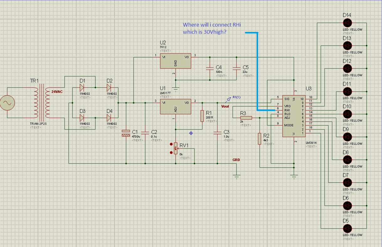

Add a 7812 regulator as shown in this image, use it to power the LM3914.

I've follow your suggestions and my problem now where will i connect RHi which 30Vhigh base to the lm3914 simulator.
Here it is. Is the circuit correct?
