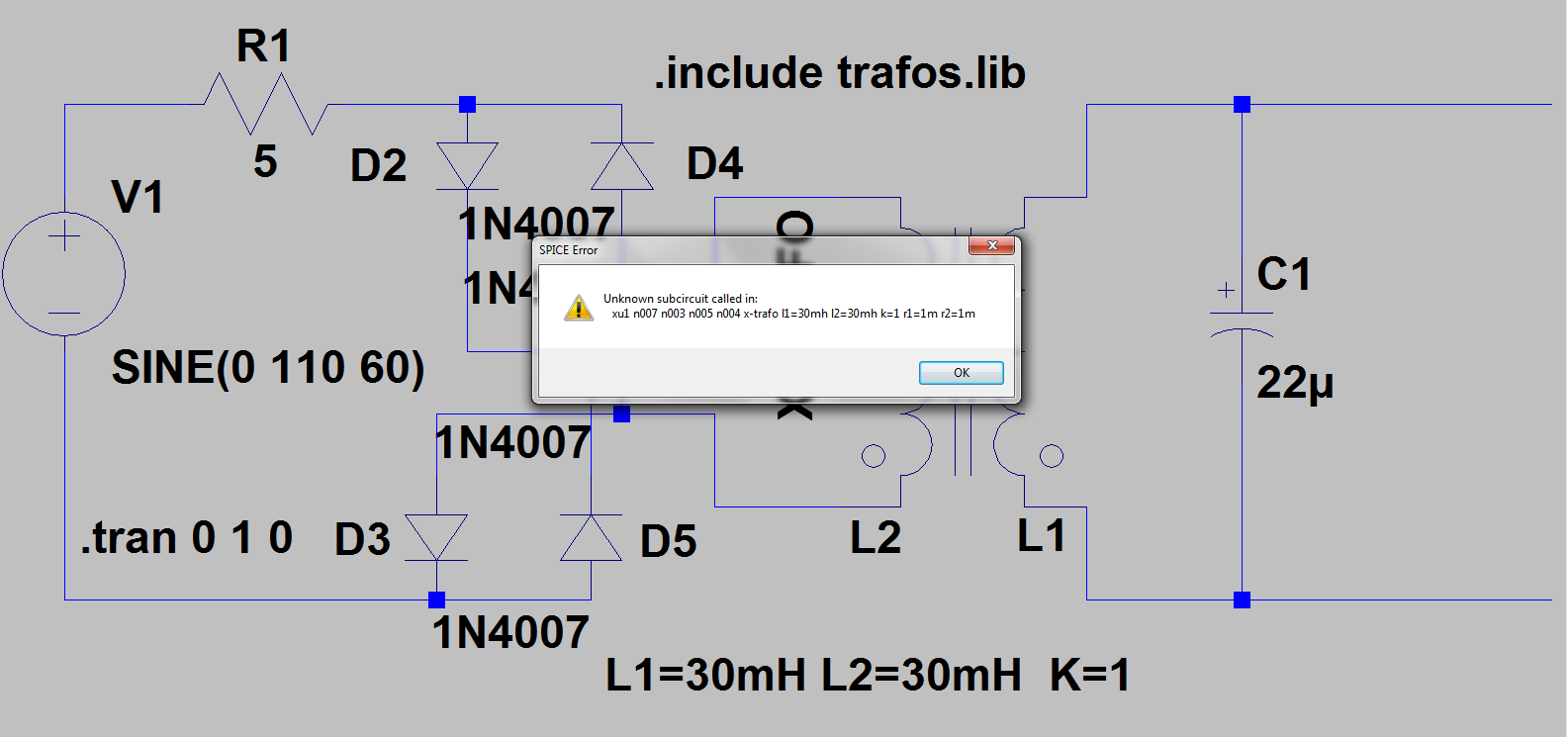

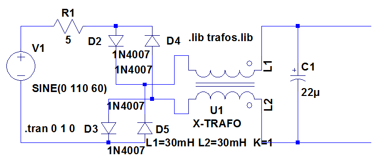

I started to simulate this circuit and the filter, but Spice can't find the transformer, and when I tried to upload the .asc file so I could post it here, it doesn't show up, nor does it with windows explorer, but when I look for it with the spice open command, it shows up but has a lock on it, can any one explain this? and can anyone tell me how to get the transformer circuit to work.

Are you using LTSpice? Where did you get the transformer library? Is the library in the "sub" folder? You can use two inductors if you define the mutual inductance, and give it a value.

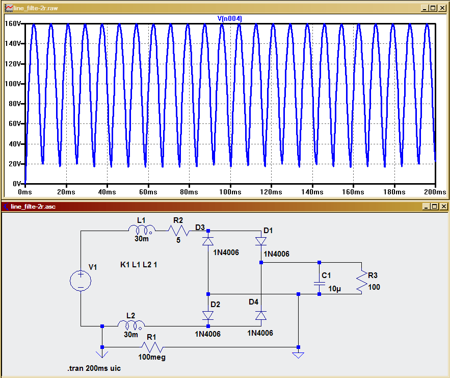

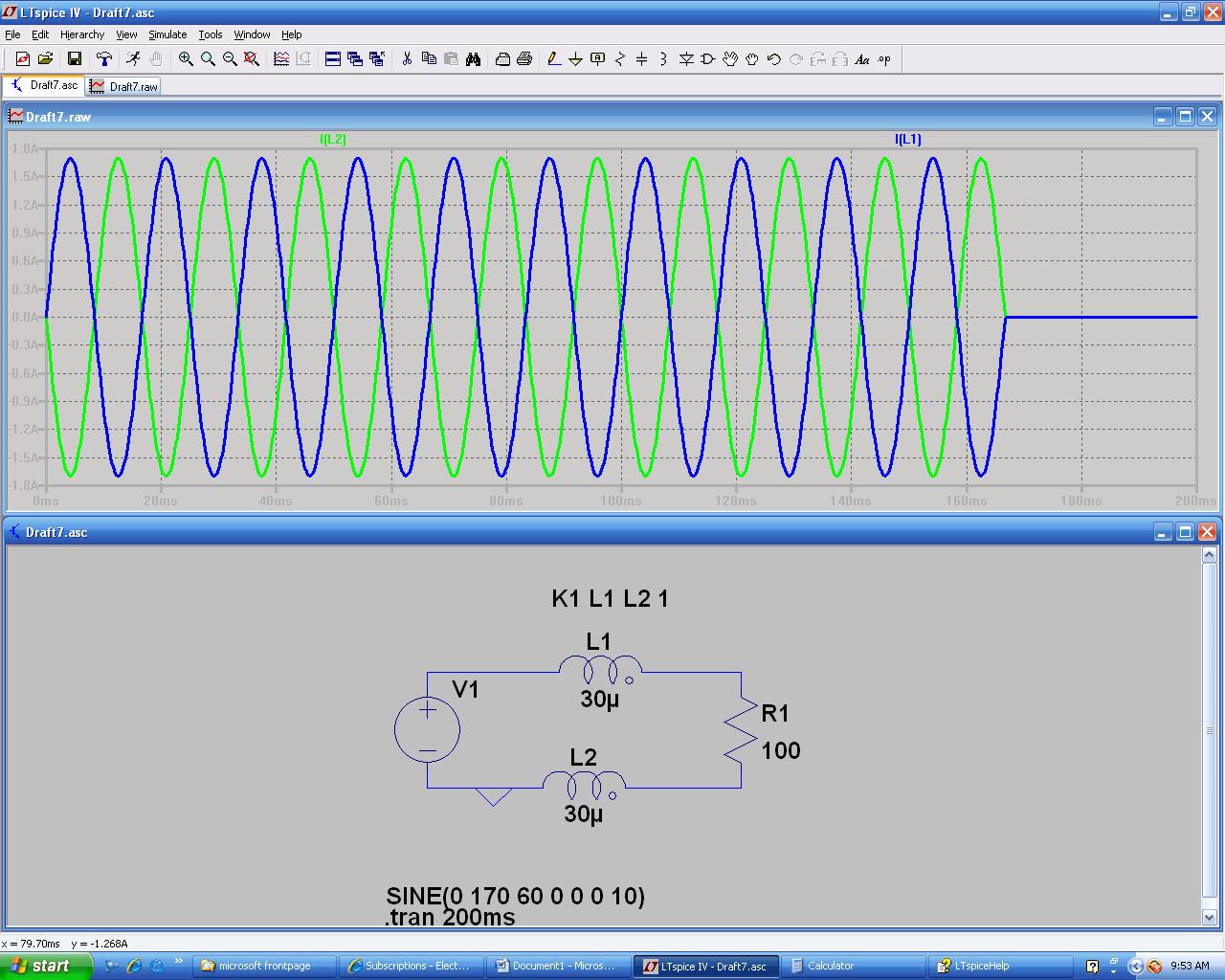

Hi again. Here is an easy way to model your filter. The line "K1 L1 L2 1" defines the mutual inductance for the two inductors. I just used the ".op" button to enter this line ( far left on the tools bar )

From your schematic, I think the library does something identical to my circuit on post #26 just above. Only they used 30mH and I used 30uH, I think.

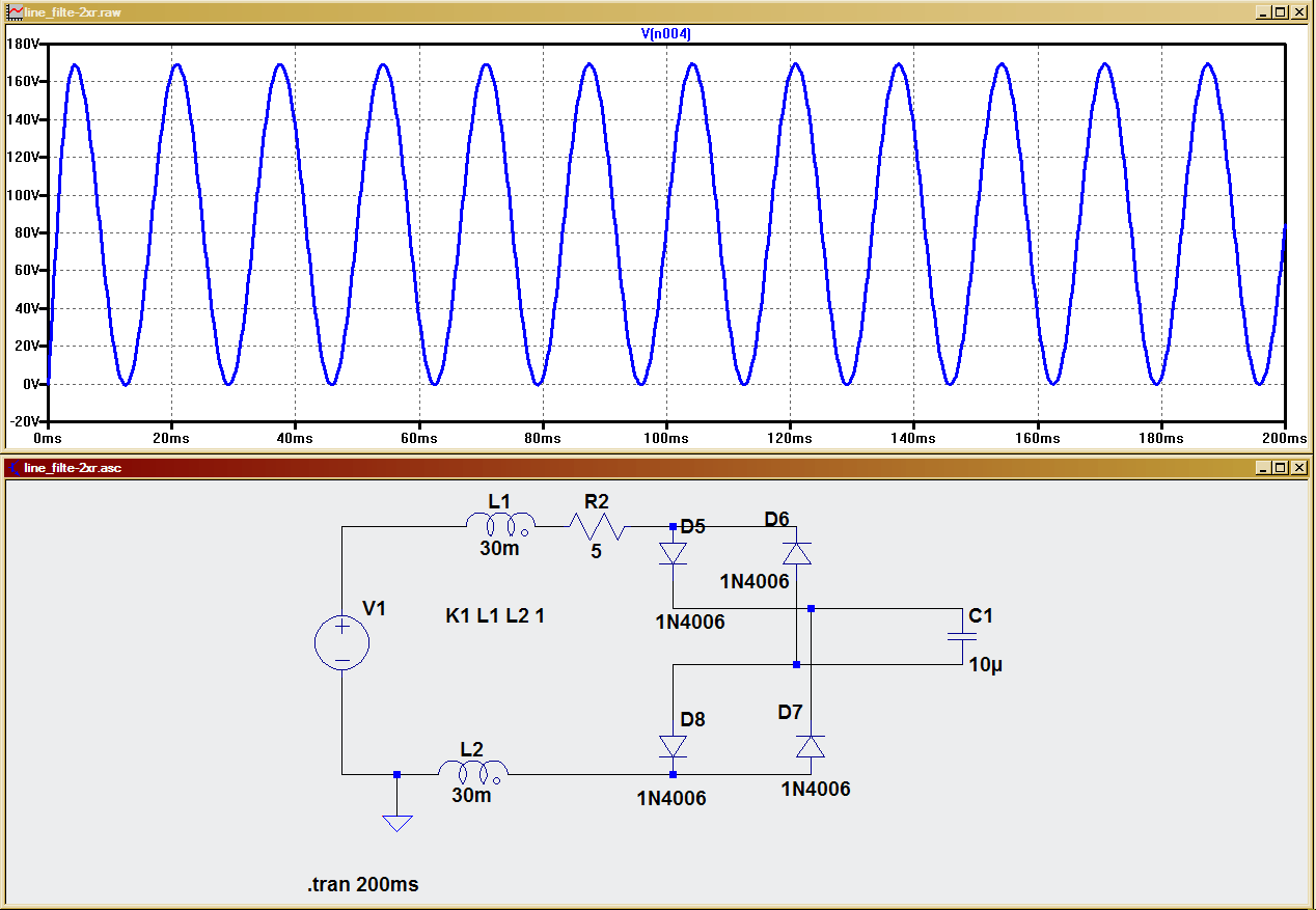

Actually, my circuit gives me an error and quits working, one thing I was trying to confirm is that the voltage across C4 is 170 vdc and the other thing I wanted to accomplish was to get my sim to sim, Oh well, onward and upward.

What I"m not getting is, if your circuit won't simulate, why not just use mine that does simulate, and make any changes you need???

Tried yours and it ran to 3.4% and then it had to much to do and stayed there but kept processing.

Interesting, on the .asc from post 32, if I put the ground ref anywhere but either side of the voltage source, it runs in no time at all, but stops at 3.4% done.

In your sim that version of the TRAFO is not included in the trafos.lib, so I cannot run it.
Using the LTspice ind2 to make up the transformer, it runs OK.
Same applies to post #23

Thanks Eric, that little trick of adding the 1 meg resistor works great. I still have lots to learn about spice & I'm learning it slower than I like, but learning. I do appreciate your help.
