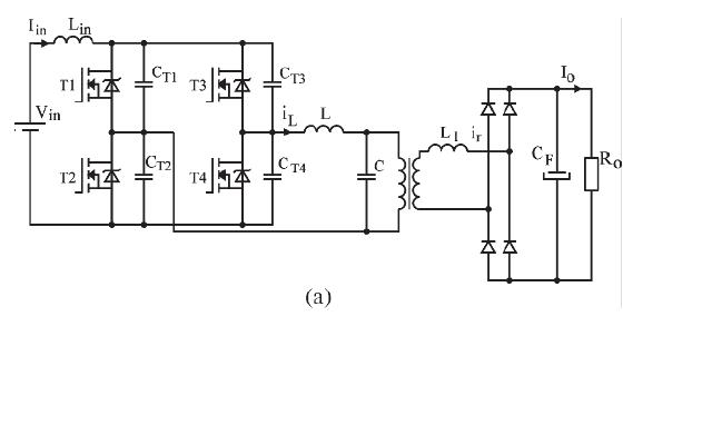

Hey..my project is doing a bidirectional dc/ac converter..as i am still new to power electronic so i am not sure whether a voltage source combine with a rectifier will give me a bidirectional converter?
can someone help me??
thz a lot
The circuit you posted is a DC to DC converter. It is not doing a bi-directional anything and is just a rough circuit illustration. What exactly are you trying to do?

Basically, i am doing a bidirectional dc/ac converter..which can turn dc to ac or ac to dc in both direction... if i take out the 4 diode which is the recifier from the right hand side, will it turn out to be bidirectional?
