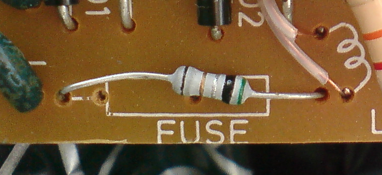

I'm desperately trying to identify this fuse.
I've spent hours trawling the internet, but I'm still none the wiser :confused:
It looks like a resistor in shape and dimensions.
I've found a few sites documenting the coloured bands on these type of fuses, but none seem work for the bands on mine :(
I've included a photo of the fuse from another identicle board I have.
Unfortunately a faulty MCR100-8 Triode Thyristor caused it to blow.
I’ve fixed the damaged components and the circuit is now working, but for the life of me can’t identify this fuse.
Any help would be greatly appreciated as it's driving me mad :(
Many thanks :)

It's a 500mΩ fusable resistor.

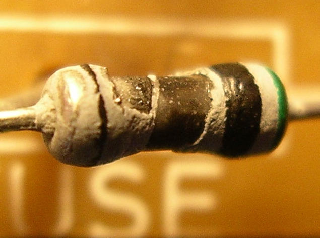

I've looked into Hero999 500mΩ fusible resistor, but they are not easily obtainable by the hobbyist :(
It does look similar to a Picofuse, but when it blew it did it big style (see attached photo - it splattered itself over the PCB and made me jump!).
Also the colour bands do give the impression of a fusible resistor more than a Picofuse.
The fuse in the mains socket is a 3amp, so I would have thought this would be a higer rated device as the PCB housing is not easily opened to replace anything blown.
I've only really got Maplins & eBay for spares and I don't want to compromise on safety.
There seems to be additional holes on the PCB for fuse holder clips (20mm apart).
Perhaps they changed their minds after manufacturing the PCB and went for an alternative (more resilient) form of circuit protection.
Would it be acceptable to fit PCB mounted fuse holder and fit a 20mm 3.15amp quickblow fuse or similar?

It's probably a normal resistor being used as a fuse.
500mΩ is an odd value, I would've expected to be something like 470mΩ.
Assuming it's a 500mΩ the rupture current will depend on the power rating but how do you know what that is?
If it's a 0.25W resistor the current which will cause the maximum power dissipation is:
I = √(W/R) = √(0.25/.5) = 707mA
That doesn't mean it will fuse when 250mW is being dissipated, it could be over 500mW and it will take some time.
It's just a gues but I'd opt for a 1A slow blow fuse assuming the resistor will blow at 500mW which would be 1A.

Step back a little, basically its a 'resistor' and acts as such unless the current exceeds the rated value and it effectively burns out.
So the colour codes for normal resistors apply.
There is is no band to say its fusible, the printing on the pcb identifies it as a fusible resistor.
Green = 5 Black = so thats 50 , the multiplier is Siver which is 0.01 so 50 * 0.01 = 500mΩ
Does this help.?:)
Ahh thanks ericgibbs :D
Its a fuseable resistor of 0.5 ohms (+- 5%)
Sometimes I'm so thick :D

I also heard about "flameproof resistors". The look a lot like your 0.51 ohmer and they blow without burning. A blown flameproof can be identified by its discoloration in the middle portion of the resistor body.
