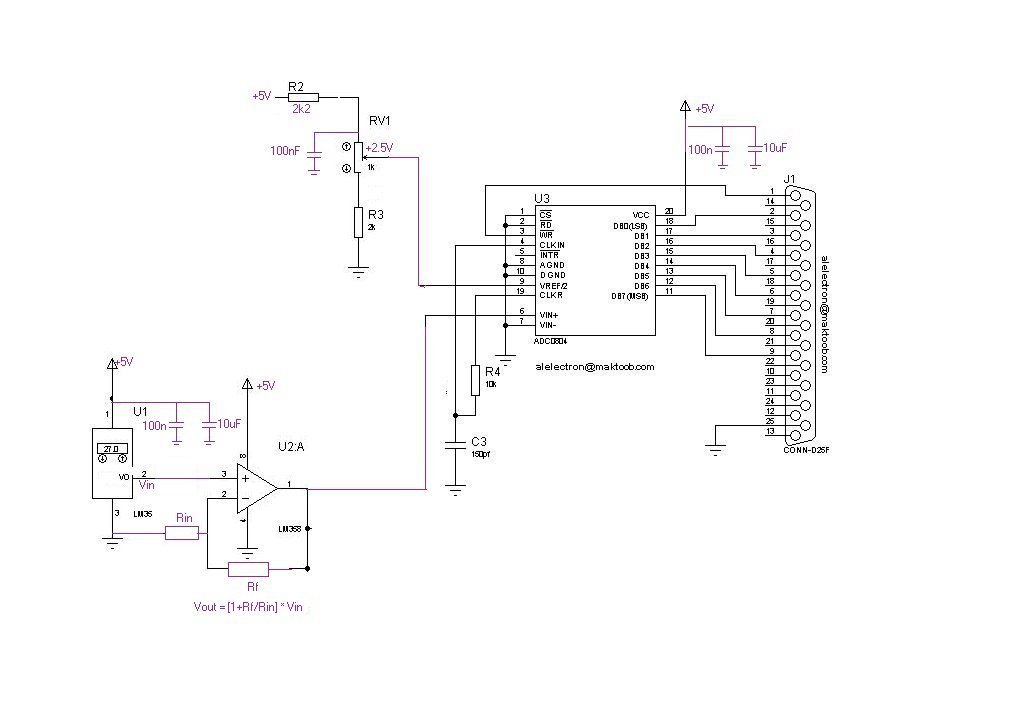

i'm working now on the home weather project using the LM35 temperature sensor.
The goal of my project is the take readings from the sensor and displaying it on the computer recipient through the parallel port, thus a program is provided here to display the readings,which is written by c#.net programming language.
achieving this issue , other components included to our circuit such operational amplifier LM358 and ADC0804 convertor.
My question here is : what is the benefit of the opreational ampilifer in our circuit ?
this is the circuit diagram of my project :

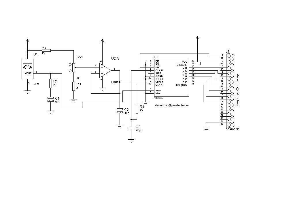

i have an other question here :
from the configuration of the circuit .... the pin9 ( Vref/2 ) and the pin20(Vcc or Vref) is related together , i mean the value of pin9 is taken according the value of the pin20 which mean, i MUST adjust the value of the pin9 by dividing the value of pin20 ..... for instance , if the value of Vcc is 5 so :
Vref=Vcc/2 = 5/2=2.5 volt .... this is the value that must be on pin9
from my searching i knew that value can be adjusted by adjusting the value of the variable resistance (RV1) ...... the question is :
Is that correct ? if it is not , how could that be ?
NOTE : check the attachment , i attached an other pic for the circuit with good resolution .
thank u

As the input to the LM358 does not have any type of pre-regulation, the LM358 is not required.
RV1 and R3 will do the same action, ie: give +2.5V to Vref
For greater accuracy and repeatability the Vref should be regulated.
Voltage references for 2.5v are not expensive.
The +2.5Vref sets the SPAN of the adc,, that means as the adc has 8 bit resolution, an LM35 input signal of 2.5V will give a adc value of 255 [FFh].
Here's a 2.5v reference I've used before with analogue temperature sensors. It requires only one capacitor (between Vout and GND) and costs almost nothing. It is in a tiny package too, making it ideal.
MCP1525
Eric, why was the LM358 included in the first place? Perhaps that part of the circuit was stolen from somewhere that wasn't using a uC input?

This is your original circuit, edited to show the LM358 as an amplifier for the LM35 output.
Set the gain of the LM358 to give the max output voltage that the ADC will accept. With a Vref of 2.5V that will be 2.5Vmax
Say your max temperature is going to be 50Cdeg, which is 0.5V outfrom the LM35, if you set the gain of the LM358 to *5, that will give a voltage input to the ADC of 2.5V at 50Cdeg.
By using the amplifier it will increase the temperature resolution of the circuit.
Effectively the LM35 will be now 50mV/degC, which is a ADC change of 5 counts,
that means a resolution of of about +/-0.2C per ADC bit.

The adc value is [Vinp/Vref] * 255 .. Pin9 is the Vref pin and Pin6 is Vinp
If you set Vref at 1.28V and input 2.5V you will still get the max adc value output of 255.
BUT why would you want to do that.?

There is nothing to get confused about.:)
The LM35 outputs 10mV/Cdeg change.
The way you have the LM35 wired on your original circuit enables the LM35 to work over the range of +2C thru +150C.
Thats a Vin [ to the adc] of +20mV thru +1.5V.
I suggested a Vref of +2.5V, this means that a Vin to the adc of +2.5V would give an adc value of 255.
As your project is for a limited temperature range, say +2C thru +50C, it would make sense to amplify the LM35 output so that a tempr of +50C would give a voltage Vin to the adc of +2.5V,,, which would give the max resolution from the adc of 255.
So I suggest you use the LM358 in your original circuit as an amplifier for the LM35.
OK.?:)
