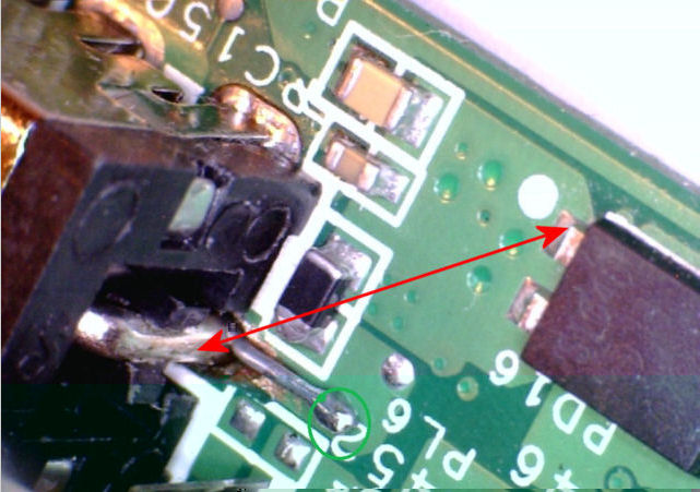

Help fixing gateway MA7 motherboard

The markings next to the components are PL1, PC2, PC1, PR81, I think the PC stands for power capacitors, the PR is resistor with not sure about the PL though.
Typically, "L" is used to indicate a coil or inductor, "C" a capacitor, and "R" a resistor... :)

The problem was fused layers on the motherboard

The MA7 and MA3 boards were kind of notorious for burning out a spot near the A/C plug causing them to no longer charge or run on A/C power. They're fairly easy to fix if you're good with a soldering iron. Cut yourself a short piece of small wire, like 22 gauge, and make a small jumper wire and solder it between the 2 points noted on the picture. That will bypass the bad spot and bring it back to life.
