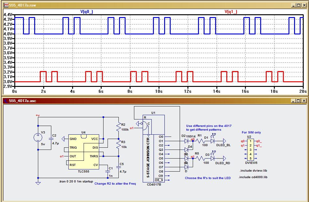

Hey guys. Pulled this flashing LED circuit out of a toy. Here is a drawing of what it looks like. Much appreciated if you could help me replicate it! I apologize for the bad drawing, but I'm a novice.
It is an LED flashing circuit where the red one flashes twice then the blue one flashes twice and repeats.
Can anyone tell me how to replicate this? Or create a new circuit that does the same thing... that is easy to make?

You could do the same flashing of two led's using a 555 timer 8 pin IC..
Thanks Eric! Can you (or anyone else) explain which pins of the 555 IC I need to attach everything to so I get the flashing pattern I described? (red flashes twice, then blue flashes twice, etc. quite fast)

For a simple device I would use say a 555 and a 4017, 4 signal diodes would give the required led pattern.

Here's one with only two chips, 4001 and 4017... https://www.electro-tech-online.com/threads/how-can-i-build-that-flasher.35516/

This simple circuit will give you the same flashing pattern, you can also change the pattern and rate, no programming required.
Get the datasheets for two IC's for the pin numbers, shout if you have a problem.
