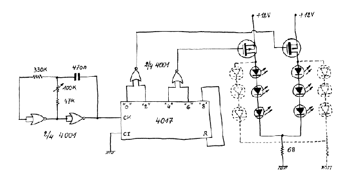

I would go for a 4001 and a 4017 and two "old" P-channel mosfets
like IRF9530 or IRF9540.

Hi HeXOR,
Like I said in my previous post, a CD4001, a CD4017 and a few old
dogs to drive the led's.
The circuit (?) was designed to be used with (blue) led's with a
forward voltage drop of 3,3 volt. You can connect as much groups
of six led's as you like and you can use (almost) any old P-channel
mosfet you can get your hands on like IRF9510 to IRF9513; IRF9520
to IRF9523; IRF9530 to IRF9533; IRF9620 to IRF9623; IRF9630 to
IRF9633, . . .
on1aag.

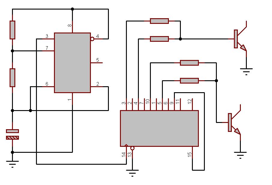

finished my flasher on breadboard - will post up a video clip tommorow. i dont have enough blue leds to do blue, so ive used some red 'marker' lights, but the circuit works exactly the same.
Thanks you guys...
weegee i hope to see yur video.
on1aag thanks you, the old P-channel is very expensive so i refer to not use that transistor.
i thont on what you said in your previous post
and i do this with 555 and 4017.
and this is what come: Attach
AND somthing more: my friend tel me that the LED IS not visible in day light.
only LED with 140 lomines (somthink like that) anh this LED very expensive .
so what can do for that situation?????
THANK A LOT YOU ALL:) :) :)

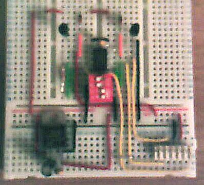

Flasher on breadboard (without the relays), very simple board.
yellow wires are the programming header.
sorry about picture quality, phone don't do macro :(
