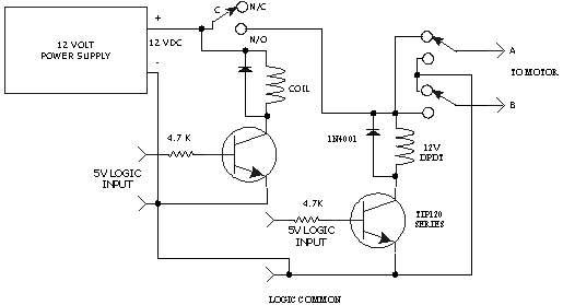

Looking at the original circuit that I posted. With the logic at 0 Volts the motor has one polarity across its terminals. With the logic of 5 volts the relay energizes and supplys the opposite polartity of voltage to the motor. As a result the motor turns the opposite direction.
The new circuit shows an additional relay. This relay turns on power to the motor circuit. It uses a transistor driver like the motor control relay. It uses a seperate logic control to activate it.
The relay in the new circuit is labeled. The labels mean:
N/O Normally open
N/C Normally closed
C common or wiper
Coil requires voltage to activate.
When selecting a relay the contact have a current rating. The Radio Shack relay that you selected will be fine if the motor you are controlling requires less than 5 amps to operate it. If the motor requires more than 5A then I suggest the 275-218 Radio Shack relay.

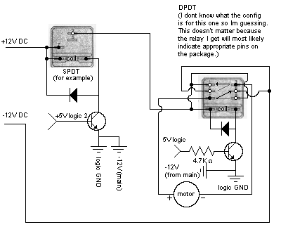

I think I finally understand most of the circuit but before I build it I want to make sure I have it right (No, k7elp60 I don't think your circuit is wrong, but there were a few minor things I was confused about, so I made my copy of yours that seems a little bit simpler to me) I'm not sure if everything is correct in the transistion and addition of the extra "on/off" SPDT relay, so it would be great if you could go through one of my schematics for hopefully the last time :) . Sorry for compressing things in a small space so you might have to zoom in near the second relay. The relay pics instead of proper schematic symbols were another simpler for me thing.
Again thanks for all of your help and ability to bear my lack of knowledge for the subject! Oh, and I just realized that I forgot to add a resistor at one of the bases.
-freeskier89

Anyone, correct me if I'm wrong, but where freeskier has connected the logic GND to the -12V, I can see this causing dramas. GND normally represents 0V. Now, if you connect 0V and -12V directly together, I would expect to see smoke, unless one of the supplies is floating.
I'm not really familiar with parallel port specs. Does the port supply float?
It depends entirely on the point of reference, which he doesn't make at all clear?. I read it as the 12V supply is totally seperate, with -12V just being the negative connection of a floating 12V supply - but it's certainly confusing the way it's written, and subject to various interpretations, most of which wouldn't work.
No, the port ground is connected to the case. All supplies in a PC are referenced to 0V, which is the case, and external ground.
I think the confusion over -12V arises, because the "-12V" rail should really be the 0V rail.
Bearing in mind, freeskier is using a 12V motor; if true 12V and -12V rails were used, the motor would have a 24V supply and very quickly burn out!
Wherever "-12V" has been marked, should be revised to "0V". Makes much more sense that way!
EDIT: Nigel, I just realised you basically said that in your previous post.... just didn't catch it... :!:
Sorry about the confusion. The + and - 12V are all on the same supply. Are k7elp60's markings incorrect also for indicating both positive and negative 12V? Would I even connect to the parallel port GND? Where k7elp60 has logic common does that mean that part is connected to parallel port GND or logic pin? Or does it mean something totally different.

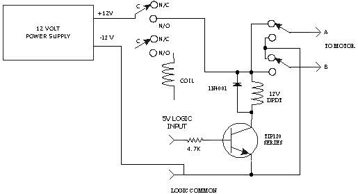

First let me appologize for the confusion in regards to the 12 volt supply. I have relabeled the schematic to indicate 12 volts with a + and - terminals.
freeskier89 your connections to the relays are incorrect from normal configuration. But as you indicated you will connect them correct with the markings on the relays. I have also redrawn my schematic to indicate the SPDT relay to turn the power onto the motor control. The important thing is to have the logic common connected to the 12V powersupply -(negative terminal)
Just so you know on relays, with the configuration you showed in your schematic for the relays. The top terminals are usually the N/C (normally closed) The next terminal down is the N/O (normallay open) and on the DPDT the third terminal down is the C (common or wiper) On the SPDT the C terminal can be in various positions.
