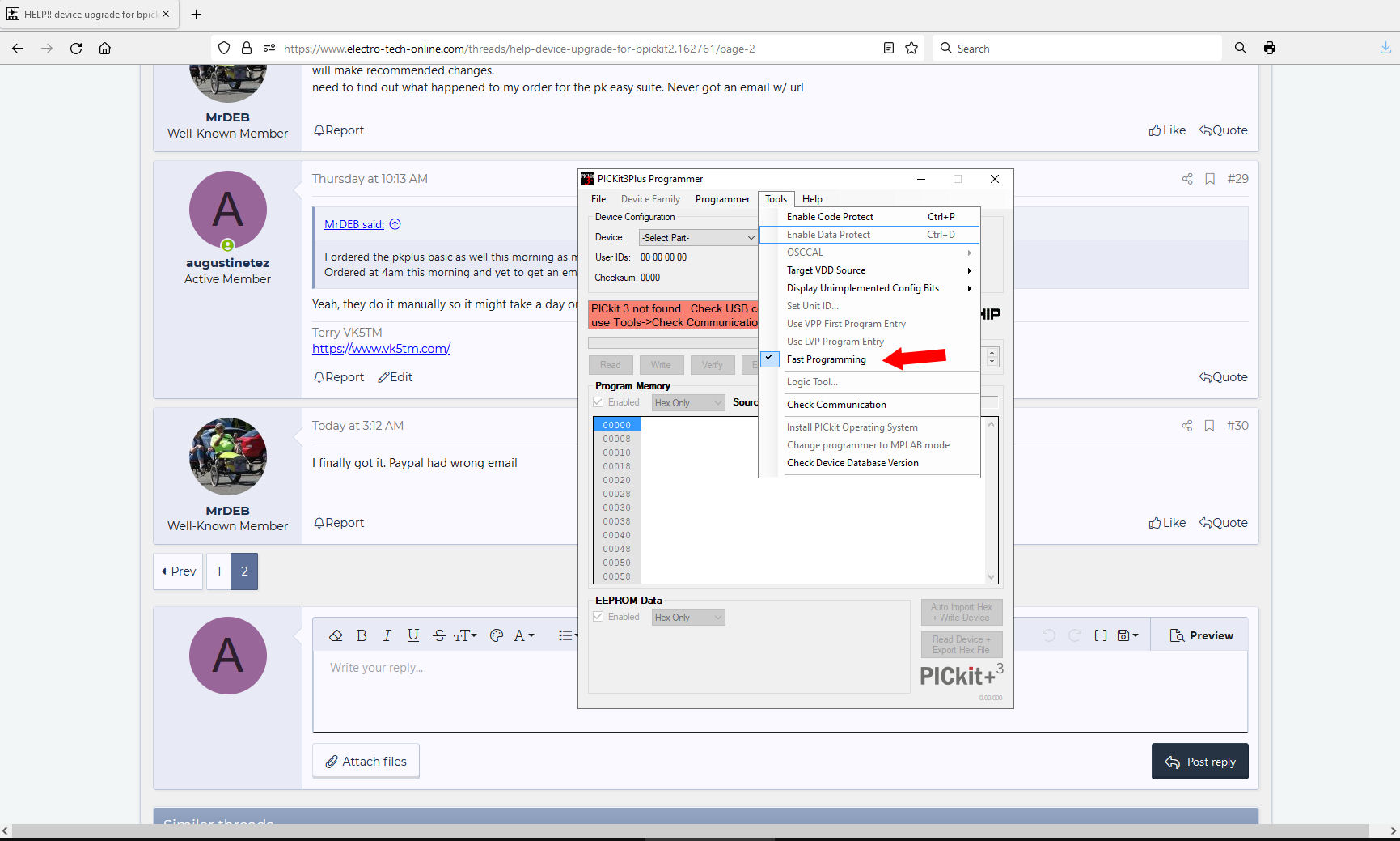

If you use a standalone socket/board to program the PICs (ie not doing in circuit programming), under tools, tick "Fast programming", makes a big difference to speed.
Dis-regard the Pickit 3 not found message in the image, I didn't have it connected.
