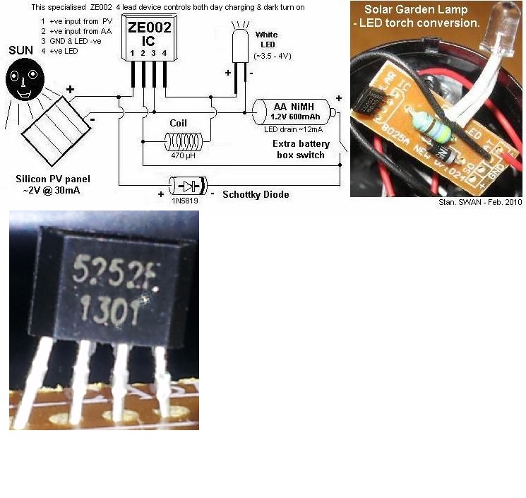

Here's an article that may be of interest to you.
  • Joule Thief modern 5252F.doc

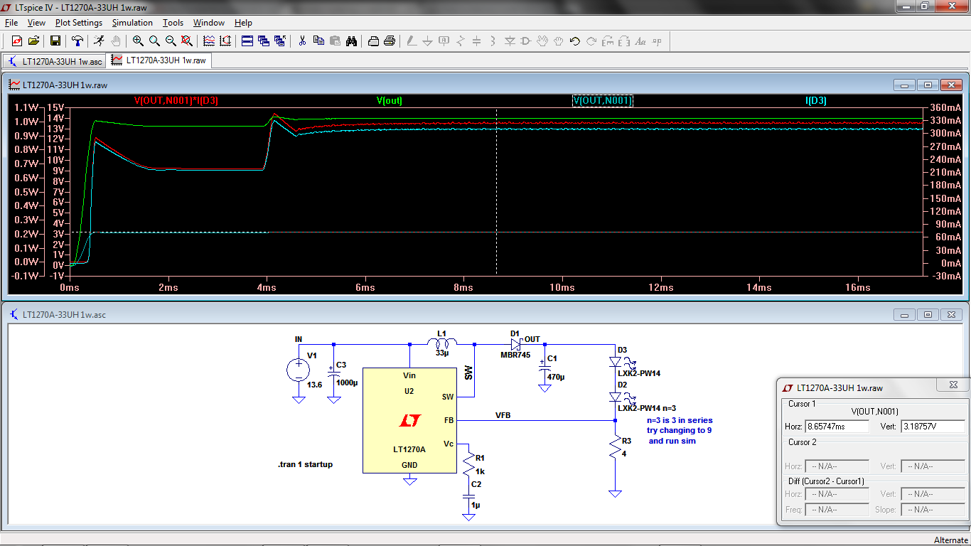

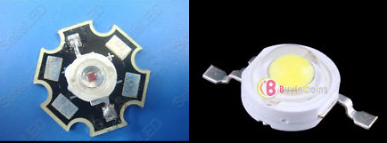

on your opening post, you said 4 1watt LEDS and a 12v battery, car bat?, is that correct? and what type of 1 watt LEDs, are the mounted to an aluminum hex star?
If you want the LED's to be constant current from 12.5 to 11.5 off battery and up to 14.2V with charger, then a constant current regulator is required.
This single chip does it all with high efficiency, and dimmable over a wide range.
http://www.linear.com/product/LT3519
  • LT1270A-33UH 1w.asc
Nice one man, the current seems very stable at 330mA. Feel like making it but out of components... Time to go shopping.
You set the current by the R3, 1.245V/4Ω=.331a A 4.3Ω 5% gives a current of ≈290mA & ≈360mW
