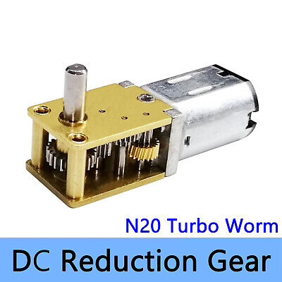

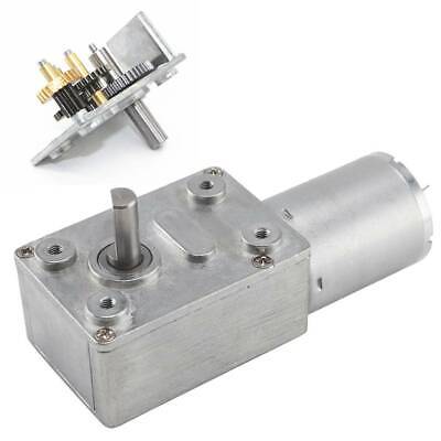

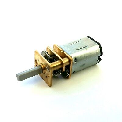

Example geared motors; the type you need depends on how fast it must and how much power the output shaft needs:
