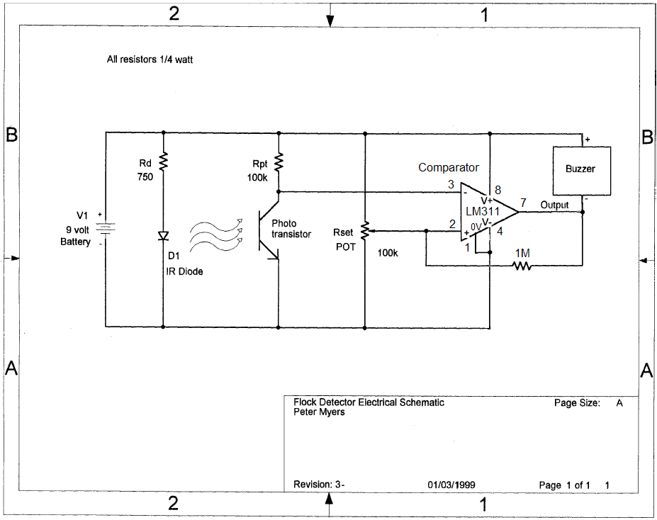

I am done, but it does not work
Hello all.
I got the parts from radioshack. Thanks.
I followed scrupulously the schematic. The only change I have made is that I used a trimmer potentiometer (1 kilo ohm) for the IR LED. That allows me to change the IR intensity. Everything else remains unchanged.
What I have is that the buzzer emits a buzz at all times.
The IR LED works (my camcorder says so).
When the IR LED is in front of the phototransistor, the resistance is very high. When the IR is away from the phototransistor, the resistance is low.
So, did I buy a PNP or a NPN phototransistor? It looks like this might be my problem?
Also, for the 100k potentiometer. I soldered the two legs of it that give a constant resistance of 100k. The third leg (variable resistance) is connected to the "inverting input" of the op-amp.
Can someone tell me in which configuration the Op-amp is? voltage follower, integrator etc.
I indeed do not get what it does.

UPDATE: I read again what you guys wrote about the phototransistor and I changed the wiring of the phototransistor (long leg to ground and short leg to positive). Now, it works.
The only thing that remains is that the buzzer emits a slight buzz, very small, yet audible and potentially horrendous when the phototransistor is lit by the IR LED. When the LED is away, the buzzer emits a loud sound.
Any idea?
I wouldn't recommend using the LF351 because it's an old JugFET op-amp which will more than likely suffer from phase inversion and therefore be unsuitable for use as a comparator.
I would recommend using an LM311 comparator with a few modifications to the origional schematic.
The buzzer is now connected from the output to +V as the LM311 can only sink current; the + and - inputs have been exchanged because of this. A 1M resistor has been added to add some hysteresis which will make it more stable.

I think I may have errored in the Radio Shack photo transistor. It doesn't say in their "technical" page (imagine that ;) ), but I'm sure it's an NPN. I had one of my students use them in a laser harp demo project. Almost exactly what you are doing.
If you use your original circuit diagram, and flip the photo transistor so the emitter goes to ground (-9V) and the collector goes to Rpt, it should work. I think Peter Meyer drew it wrong and my brain was else where.
Sorry.
Ken
I did think that was odd, I've never seen a PNP phototransisor before.
If it's a PNP then the schematic is right, if it's an NPN the emitter and collector connections should be reversed.

I guess that for my upcoming field work, he design I have will work. I can also remove the buzzer if it bothers too much and look at the voltage output.. or event look at the phototransistor resistance. I am indeed running out of time now.
I will however order the parts for the lm311 comparator design. THANKS!
However there are many LM311 : LM311N, LM31M, LM311DP, LM311P. Which one should I pick?

They're basically the same part apart from the LM31M which is probably a typo, you probably mean LM311M which is a military specification device.
The differences are temperature range, case style and some might have a slightly better specification than others. Choose a through hole device with the desired temperature range.
If you have any resistors laying around try putting them in series with the buzzer to lower the volume. Or a pot if you have an extra one so you can adjust it.

Also, I tested the flocculent sediment sensor tonight.
The first surprise was that the buzzer went off when the sensor touches the water. Water attenuates IR very fast, but I did not expect it with an IR LED placed at 2 cm away from the phototransistor.
I tweaked the trimpot of the IR LED and increased the IR until the buzzer stopped buzzing.
When I touched the flocculent sediment, the buzzer went off. So, it works in the lake on campus... but the lake I shall survey next Thursday has murky water. So I guess more tweaking will be needed.
To the worst, I maybe will have to move the sensors closer and this demands some substantial work. I hope that when the IR diode is maxed out (See question 2 below), the murky water will not cut the IR beam off.
In the future, I will have two potentiometers that I can tweak without opening the box where the electronics is. It looks like there will always be a need for some tweaking.
Question 2:
Last question, what would be the minimal resistance I should put to protect the IR LED? Right now, it is directly connected to the trimpot... and as you know, these guys are very sensitive (1 turn does it all).

Assuming you're using the LM311 there shouldn't be any voltage across the buzzer when it's off, the 1M resistor shouldn't pass enough current to power it. If it's a problem, put a 100k resistor in parallel with the buzzer.
Were the electrical connections to the back of the sensor fully water proofed?
If not, water could have asilly got in and short circuited the sensor making the circuit think that it was illuminated.

The 741 opa as mentioned is a very old device and has a poor specification.
One of its short comings is its limited output voltage swing, its not from 0V thru Vbatt, but more like +1.2V thru Vbatt -2V.
That +1.2V maybe just enough to keep the buzzer sounding, you could try adding a small diode in series with the output of the LM741 and the buzzer, that would drop the 1.2V down to about 0.4ish.
Diode Anode to the LM741 and Cathode to the buzzer.
