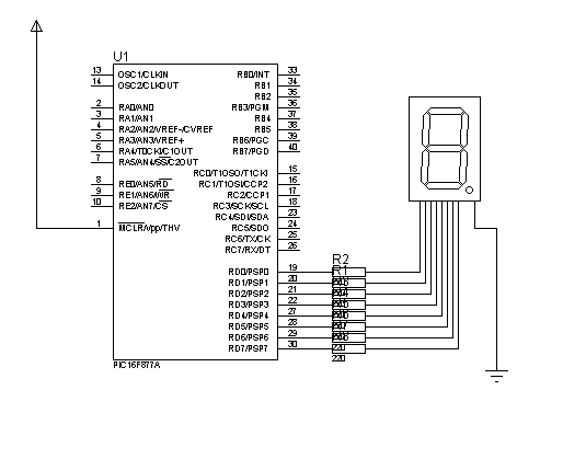

hellllllllllllllllp about 7 segment
Just one!!! Its easy... two, three or four just ground through a separate port
im soooooooooo thnkx for u but can u tell methe code to operate by microbasic prog
i used it by decoder but there problem this code
program hh

You need a simple lookup table ...
  byte CONST LED_MAP[10] = {0x3f,0x06,0x5b,0x4f,0x66,0x6d,0x7d,0x07,0x7f,0x6f};
to represent each number
I don't use micro basic but the lookup usually looks like this:
sub send( index as word)
   character = lookup(0x3f,0x06,0x5b,0x4f,0x66,0x6d,0x7d,0x07,0x7f,0x6f), index
   PORTD = character
end sub
index = character to display
Microbasic's lookup will be different
Someone will help you if you show some interest. So far you've only shown you need the solution and that you don't care how it works. The circuit diagram was posted for you.
Do you know how a 7-segment display works?
Do you know how to write a value to a port?
