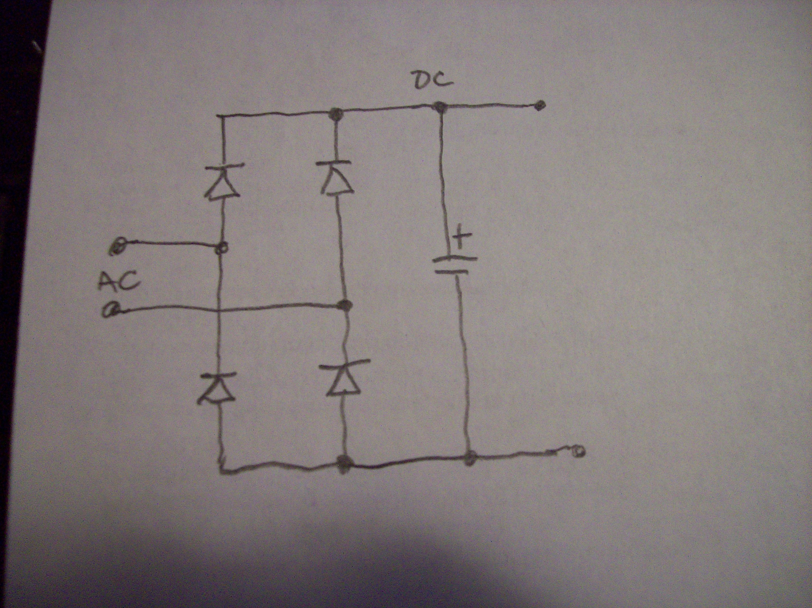

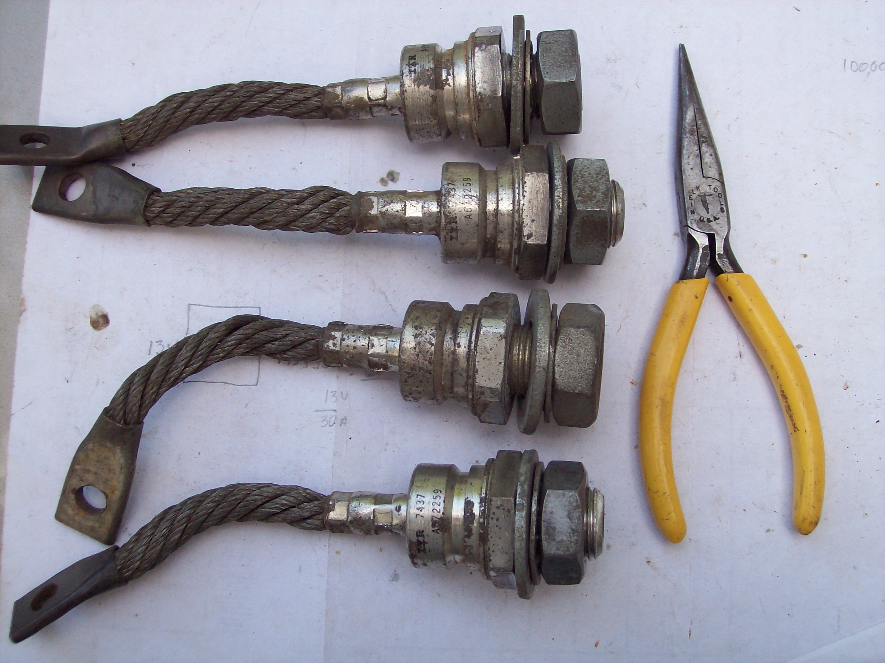

My only power supply at the moment is a car battery. Bridge rectifiers in the power supply circuit shorted out. I need some good power diodes for a bridge rectifier or a power bridge rectifier. The 250a diodes i have will work it is over kill for this tiny circuit but I can use it later on the larger H circuit up to 1500W. My power transformer is 21 vdc at 1500w. My biggest problem is LARGE heat sinks I don't have any.

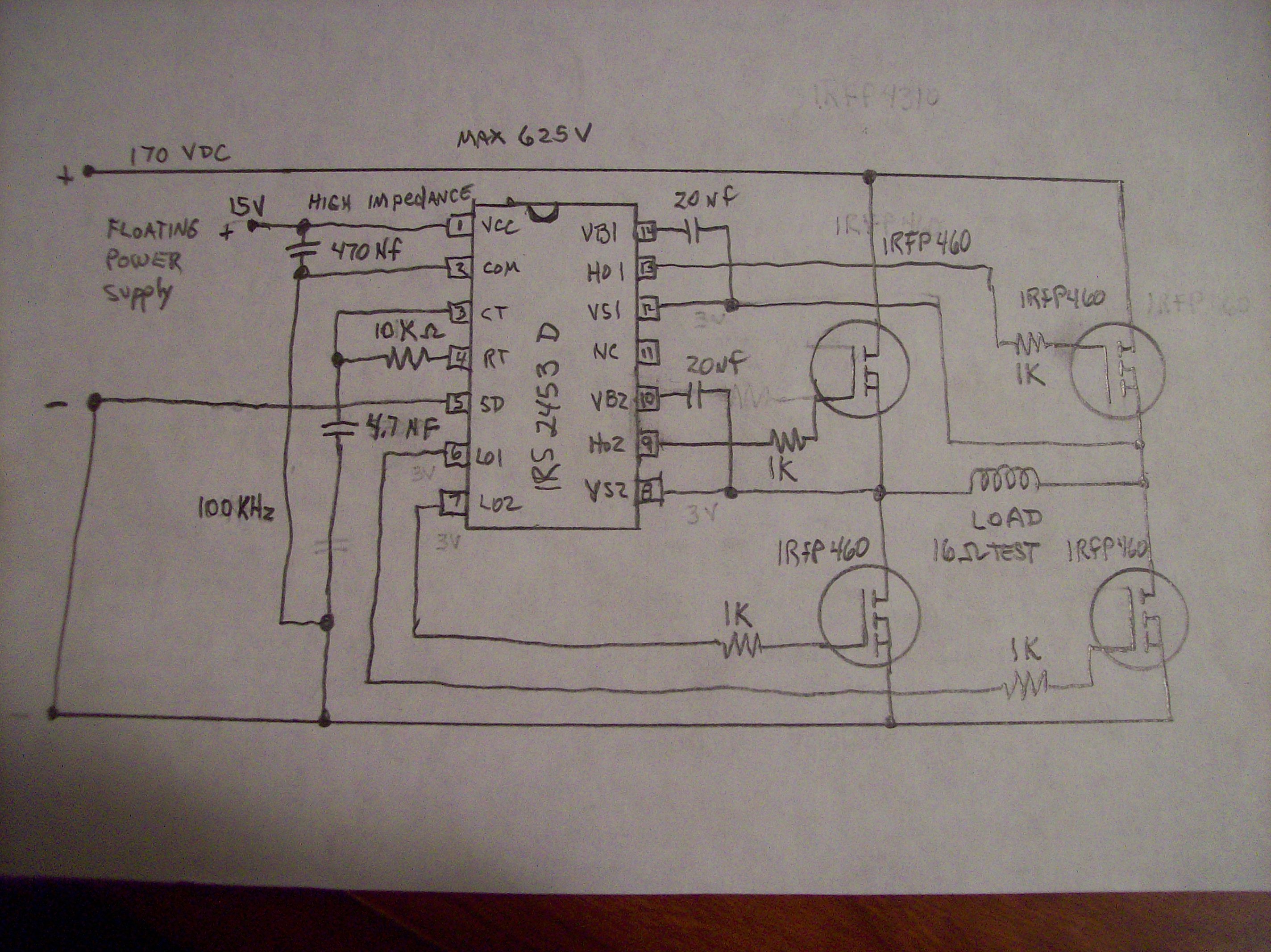

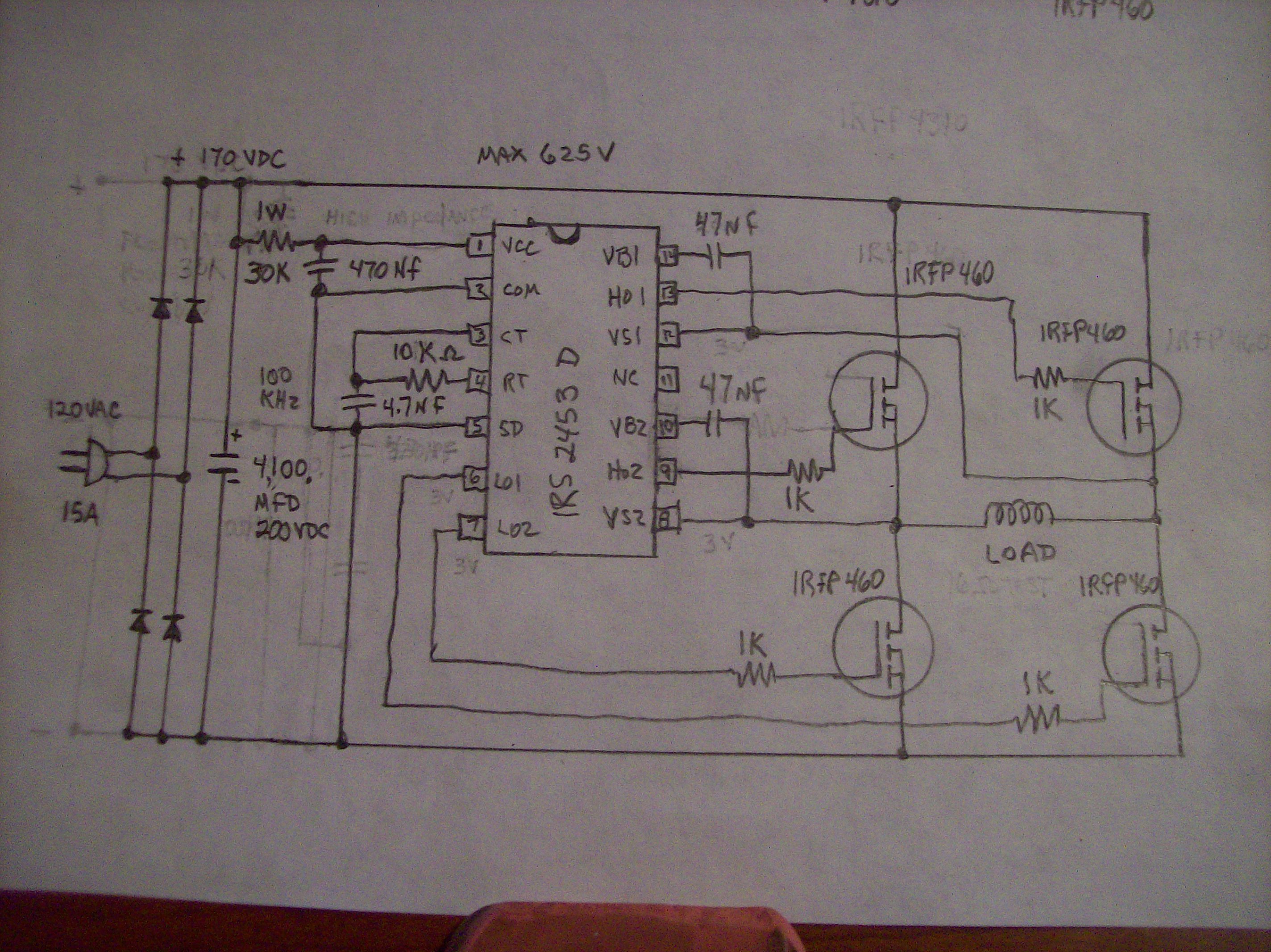

I need help. Here is the circuit from the IRF2453D datasheet.
What is a high impedance floating power supply?
I assume cap across pin 1 & 2 is the PS filter cap?
None of the caps or resistors are marked datasheet refers to VB1 cap and VB2 cap etc. I set the value of cap & resistor on pin 4 to run at 100KHz.
After reading all the datasheet info I have no clue how to set cap & resistor values for pin 14, 13, 10, 9, 7, 6 ?
Power supply will be 120vac wall outlet, bridge rectifier, filter cap. = 170VDC
What about the Load coil can it be any, size, shape, diameter, length, any number of turns?
The device has an internal zener for the pin 1 supply, so the feed to that must be from a voltage above the lockout release (12V) and anything up to the HT supply, via an appropriate resistor to set the current to 5mA.
The "VB" caps are "bootstrap" capacitors, they work in a charge pump system, charging when the upper sources go low and discharging to feed the upper gate drive sections when they switch on.
The value needed depends on the switching frequency.
This is for a different driver, but the principles should be the same:
What is a floating high impedance power supply?
Does this circuit look right?
120465
The bootstrap caps are probably too small; another data sheet I found says they must be greater than ten times the FET gate capacitance, which is 4200pF according to the IRFP460 data sheet.
That makes the minimum 42nF so probably 47nF (or bigger) using standard values.
I explained the "high impedance" supply already - it's supposed to be a 5mA current feed.
The simplest option is a 30K resistor from +170V to pin 1.
It will be dissipating around 1W; I'd use three 10K 0.5W or 0.6W in series.

Is it possible for bootstrap capacitors value to be too big? I can try 47nf how will I know if this is the perfect value? If I go bigger how will I know if the value is too large?

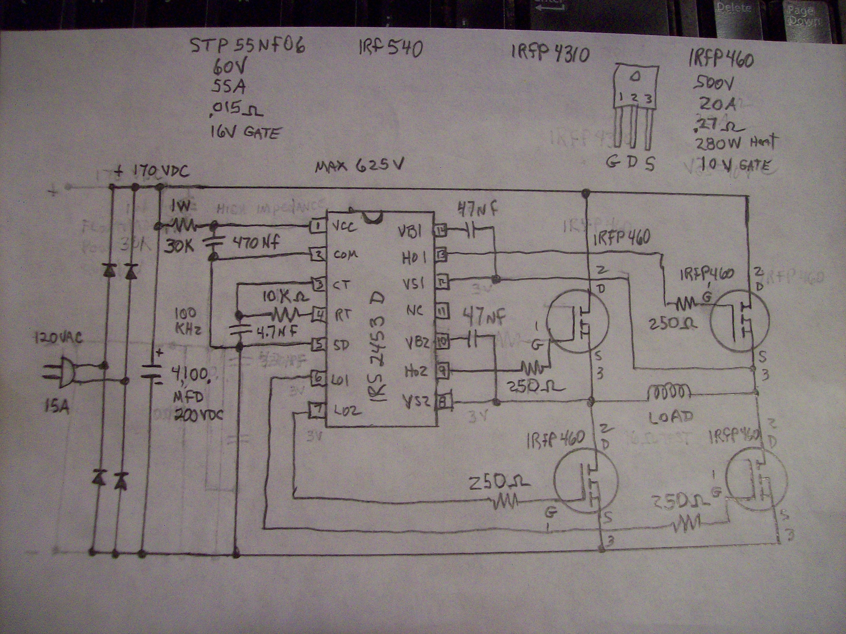

New circuit drawing.
Why are you using such a high gate resistor, 1K ! Some where around 50 ohms is normal. The 1K(or higher) would be normal for the Gate to Source resistors that you don't have.
1K is a temporary guess. Is there a way to calculate the correct resistor? My other circuit no load idle current with 220 ohms = 5a on the meter. 240 ohms = 1.5a on the meter. I think gates are still not completely turning off. 250 ohms might be a better choice to get 0a on the meter. I have not compared datasheets until now. I should probably test this circuit on 15v before trying 170v. I don't understand this circuit what limits current there is no choke. I don't see Gate current on datasheets.
120488
There is no steady-state gate current, there is a high gate capacitance to charge as the drive voltage changes between high and low.
The resistor is a balance between not overloading the current drive capability of whatever is controlling the gate (if it's too low) and making the switching time unreasonably long if it is too high - causing a lot of power loss as the FET is part-on for some time.
If by the "other circuit" you mean the self-oscillating one, the resistors ion that have a different function and cannot be used as a direct comparison.
The IRS2453 sheet mentions 180mA output. Without going through the sheet to find if that is peak or average, 100 ohm gate resistors should be safe.
Lower is better but I don't know what the IC can stand, I don't have time to read the data in detail.
The driver IC only appears to have a set 1uS dead-time, that's all it allows for one FET to turn off before the other is turned on.
With a circuit like that & a driver without built-in current sense, the normal method I've seen is to use a low value resistor in the connection to the source of the bridge FETs (lower centre rail in your drawing).
Then have a comparator between that and a preset fed from a low reference voltage. If the current is too high the comparator is triggered and that feeds the shutdown input to the driver.
I do not know if the shutdown on this IC works like that...
ps. If you are considering using this to drive the same coil as in the previous design, I'd advise against it. It is not suitable to drive a tuned coil.
Also remember the change in power is proportional to change in voltage squared; ten times the voltage means 100 times more power and everything needs to be built based on that, plus plenty of excess capacity in case of miscalculations.
You using 170V on an induction heater? Are you trying to win the "Darwin Award'?
Why are you going from one type of circuit for this to another? Don't you have Google? Google "ZVS induction heater circuit" and you will get some real circuits that work. Somethings like -
Both of them are well known and the circuits are proven and work.

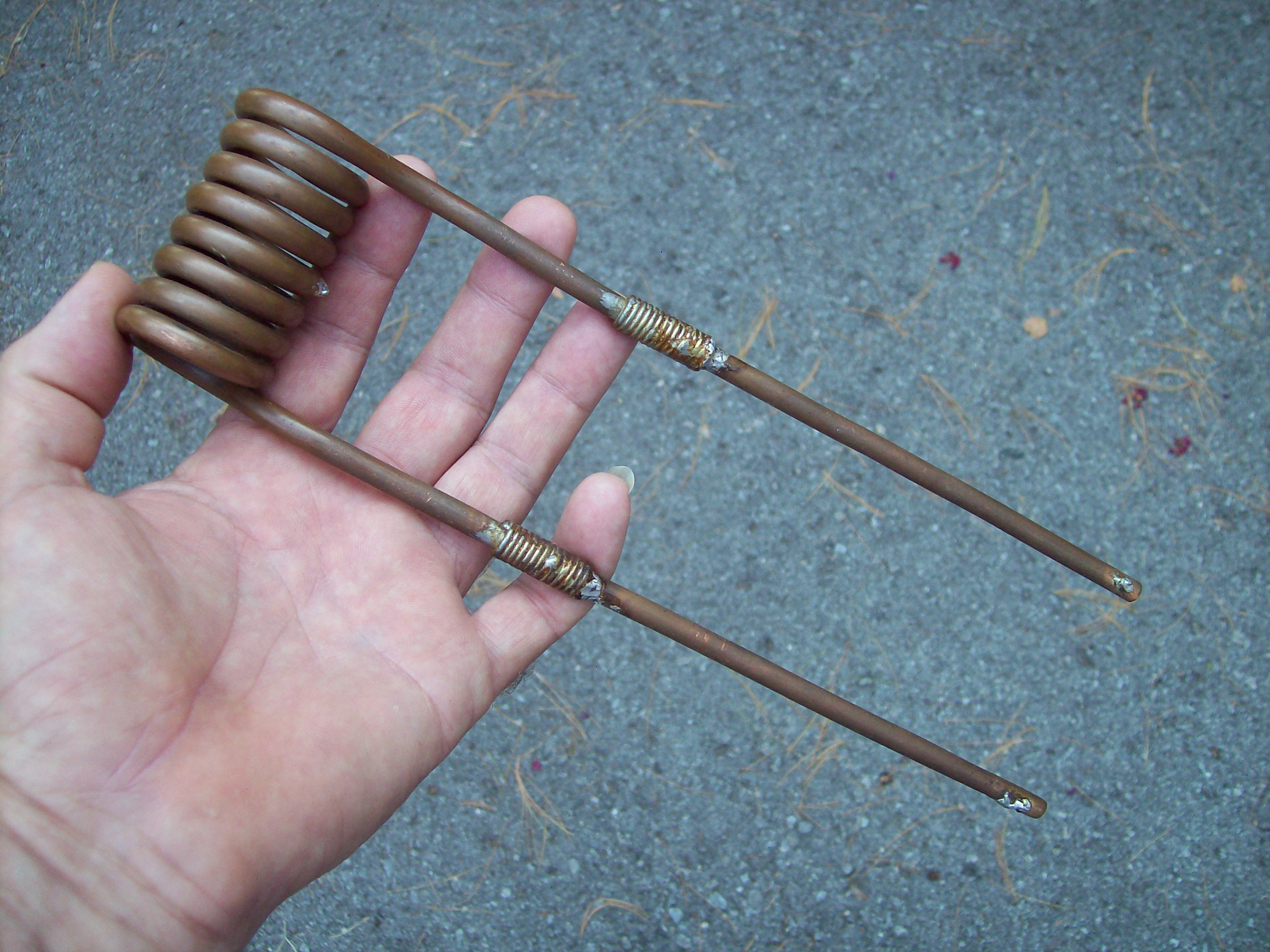

This is the work coil I made for a larger project a year ago but never used it. I learned from the other project if the work metal piece touches the uninsulated coil the mosfets all go up in smoke that is why I only make insulated coils now. Will this uninsulated coil be a problem or does it need to be insulated? I was planning to have water cooling on this coil but maybe not at first it should work fine for a short 10 second test. 8 turns, 2.75" long, 1.25" center to center diameter.
