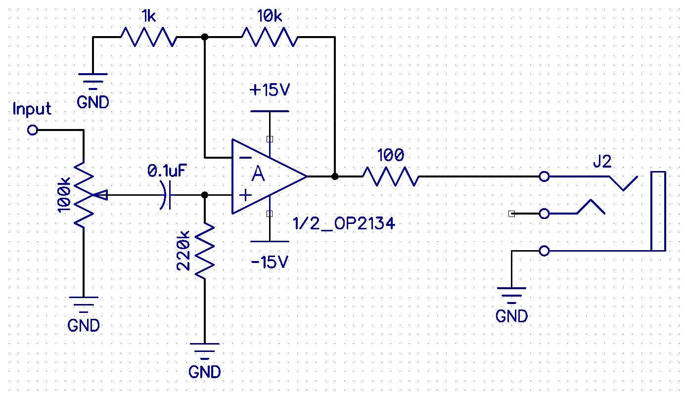

What would be your suggestion regarding this attached circuit I just drew up?
Edit: Those supplies should be +/- 12V, I grabbed the wrong symbol by mistake.

I checked them out and, between somewhat frustrating website timeouts, found the basis for the circuit I attached to post #15. Does it seem appropriate to those more experienced with headphone circuits?
should you not decouple / isolate the output?
Not needed.
The OPA2134 has an input offset voltage of typically 0.5mV. The DC gain of the circuit is 11 so the typical output offset voltage will be only 5.5mV which is nothing.
The OP2134 has FET inputs so it does not have input bias currents in the resistors.
