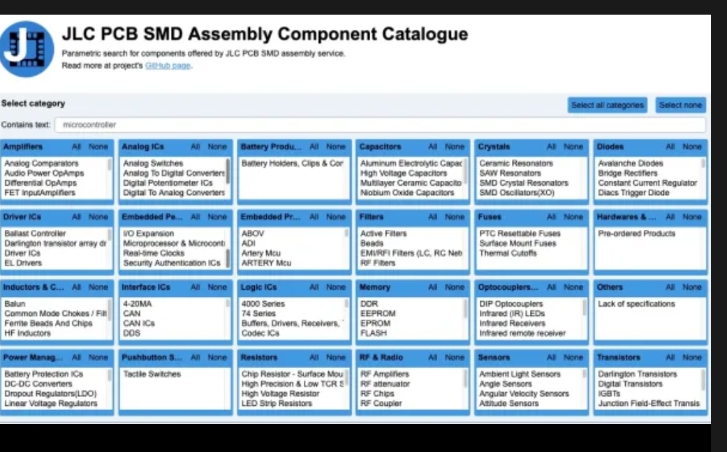

This is what I see for that part in the normal offline version of EasyEDA:
I can't recall exactly, but it seems like a few steps were required to load the search tool. I think the Git Hub page has instructions.
After you enter what part you want to find, some fields below need choices selected. Say you searched for LED; there would be a number of fields that need selections made, like mounting type, size, color, lumens..... You don't have to set all of the parameters, but you probably need to set at least one to narrow things down.
