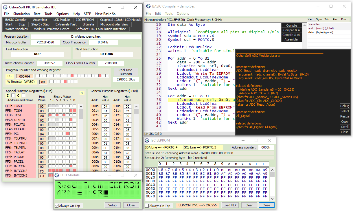

Hi M,
It may be good for you to download the evealuation free compy of the Oshonsoft simulator here:
I think you get 30 free goes, so you'll get the errors I get.
