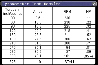

This board is connected to Motor type: NPC-T64 (very powerfull motor).

The motor starts and stalls with a current of 110A but the puny little P-channel Mosfet blows up with a current that is more than "only" 74A.

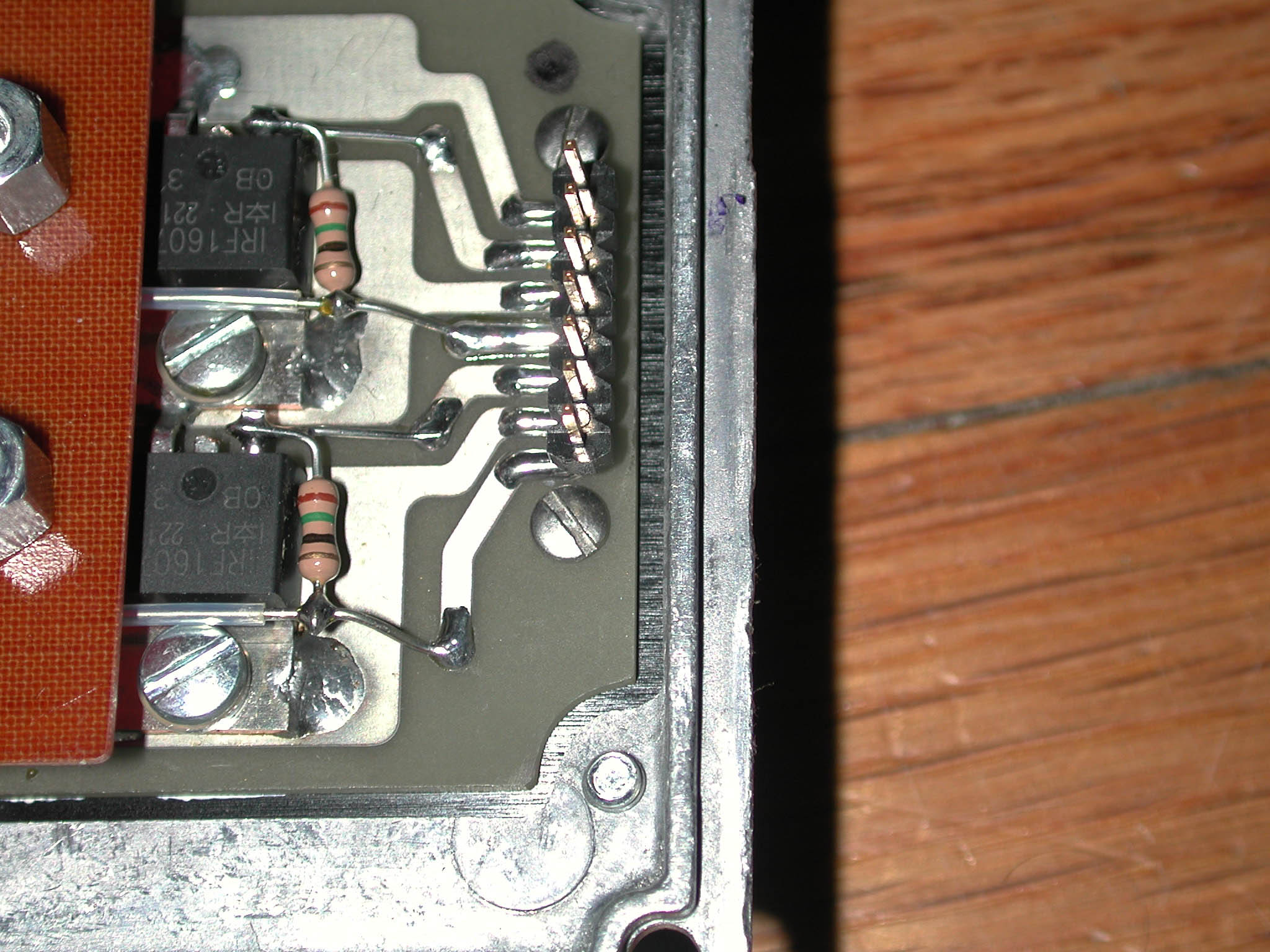

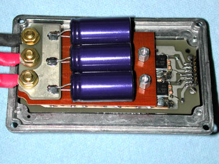

I have built two using basically the same design. One runs an old Ford 6V starter motor at 12V ("long-shaft" starter, used now in tractors) and a 12V treadmill motor that was rated at 1.5 to 2 HP. The basic design used a TPIC2101 to create PWM, soft-start, and allow logic-level control. A bank of paralleled mosfets (each with its own gate resistor) was driven by an LT1158. I had a main capacitor as suggested by 4QD in its site. I used IRF3025, IRF1010E, and IRF1607 mosfets with either 4 or 5 for each leg. It was only a 1/2 H controller as there was no need to reverse. I don't know what the current was, but the Ford starter could actually be stalled briefly and not pop the mosfets.
I would be happy to share the schematic, but 1) it doesn't show the mosfets, as that part of the design was done in a CAD program; and 2) there is some logic and detection circuitry that is not relevant. Just follow the datasheet for the LT1158.
Here are some pictures.
John
