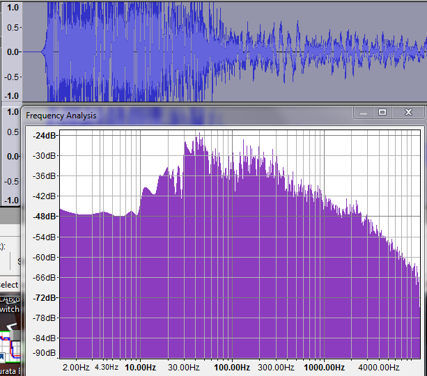

I want to start project about gunshot sound detecting, i search for it with google and read a lot of article.
but i don't know how can i start it.i mean at first which type of microphones i need and then what is the circuit for this high frequency sound to detect.
i can process sound in Matlab but i don't know how can i do this in micro-controller such as Arm and Avr.
i want to hear sound with microphones and then send data to micro-controller and then the micro analys the sound at last if the sound is gunshot sound , micro produce sound to alert.

You may want to start with the microphone being directional or omni-directional? Do you want to just for example analyze a single gunshot and then another or using multiple microphones isolate a gunshot location and the type of gunshot such as rifle, shotgun, handgun?
There are systems out there for detecting gun shots but you need to decide what you want to do with the data.

So many variables! The report of a gun is similar to that of a thunder clap, shunting rail cars, two books slapped together and so on. How large is the area to be protected? What kind of terrain? Open land or wooded? How far are the monitoring stations apart from each other? Is there a common grazing or watering area? Is there a large body of water? Is there a manned (24/7) monitoring station? What is the budget?
I could go on and on....E
it's large area, about 10 km * 10 km.at first in empty area we test it and then in jungle if it work.
and i found a lot of article in internet about characterization of gun sound and i know it's properties. and i know it's sound can detect 2 km far away from the sound location in quiet area.
and don't worry about the budget, i want to create the example model of this for proposing it to them and then we talk about budget.

I split it to 2 part. first recognizing the gunshot sound and second the location of sound.
at first i want to recognizing the gunshot sound by micro-controller, the second part is for the future if the first part done.

I might point out that the Arduino/msgeq7 system I suggested is capable of handling stereo inputs.
If the Arduino had two of the msgeq7 units, four microphones could be placed facing four different quadrants and if configured correctly, they might also be able to assess the general direction of the gunshot location. Of course, each microphone would have to be appropriately aimed and "coned" to only "listen" to one, each, of the quadrants.
Sound amplitudes should allow for this differentiation.

You can, of course, also triangulate by the difference in time each microphone detects the gunshot sound.
Since sound travels only about 1 foot per millisecond, you should be able to triangulate with reasonable precision using normal speed microprocessors.

A wise decision. The shot location technique used in the paper (they say near and far) is a form of Multilateration (direction) with Trilateration (distance) so that's why they need at least 4 mics and accurate clocks for a basic system.
https://www.isis.vanderbilt.edu/sites/default/files/49.pdf

This project will be mostly about DSP code. So perhaps one way to get started quickly is to use a general purpose PC with a good sound card with extended frequency range capability (like up to 50 KHz?).
Your block diagram would include one or more general purpose microphones feeding amplifiers and A/D converters to allow the audio to be digitized with good bandwidth. Once digitized, you can choose any computing platform that supports the algorithm that best helps detect the sound. All of your detection, filtering and other signal processing should be done in DSP, not in hardware. As a result, your hardware can be any general purpose audio A to D front end.
