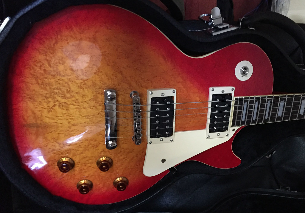

I have spent many years playing guitar. I own what is not a huge collection, but certainly what is decently representative of the various categories and varieties of that instrument. I own acoustics and electrics, solid bodies and hollow bodies, 6 and 12 strings, classical and jazz.
Most of them are well-known makes and models, even if vintage, but then again, so am I.
With the acquisition of a 3 pickup Les Paul SG Custom, I discovered that the stock configuration gave me very limited choices where pickup selection, volume and tone were concerned. I began to consider how I might improve the situation, and that is where the idea for this project was born.
This particular guitar has what are called "tarback" humbucking pickups[1]; they have wound bobbins immersed in a hardened black epoxy resin. There is no way to modify them; any attempts at that will likely destroy them, and considering their particular "vintage" sound, that would be a loss.

Given 8 edge positions for the switch plus a center position, and 3 levels for the switch body, I get 27 possible selections.
I will readily grant that some of these combinations may have sounds which are very similar, and I will also grant that there are combinations using humbuckers which are split and running in single coil mode which are likely to have more distinctive output.
There are certainly enough mods out there, such as quasi-humbucker and partial out-of-phase modes, to make the number of potential combinations dramatically greater.
Once I have this circuit built, I can sit down and play the combinations I have outlined here, and then add/drop some in order to produce the widest variety of tonal options.
The main thing right now is to get it off the ground.

How are you going to power the electronics and where are you going to put the power source and the electronics module in the guitar?
You have said it is to be reversible and no extra routing, so what space is available?
The minimum power source (without going to switched mode boost converters) to run good quality analog switches with decent signal handling range would be two 9V batteries. Higher voltage would be preferable.
I think probably, at a quick estimate, three x 16 pin analog switch or multiplexer ICs per pickup for matrix & polarity switching, plus a diode matrix or ROM to convert the physical switch output to logic control for the analog mux's.
There will be some capacitance involved in the ICs and PCB tracks, which will affect the tone to some extent unless an active buffer amp is added to each pickup (which would then need two stages for non inverted and inverted outputs) before the switching matrix. That adds serious complications in how to do series-parallel switching, which needs "raw" pickup signals.
So where???
Mechanical switching has lower capacitance, takes less space and does not need power.
