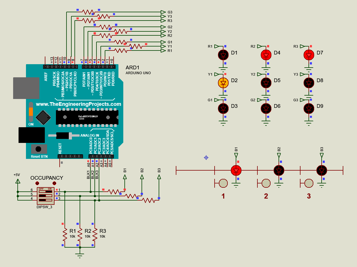

Amended code below, and (hopefully) a screenshot of the project.

Hi Deltech
There are some discrepancies between your schematic and your code .. .. ..
C:
const int R1 = 2; // choose pin for signal 1 RED aspect
const int Y1 = 3; // choose pin for signal 1 YELLOW aspect
const int G1 = 4; // choose pin for signal 1 GREEN aspect
const int R2 = 5; // choose pin for signal 2 RED aspect
const int Y2 = 6; // choose pin for signal 2 YELLOW aspect
const int G2 = 7; // choose pin for signal 2 GREEN aspect
const int R3 = 8; // choose pin for signal 3 RED aspect
const int Y3 = 9; // choose pin for signal 3 YELLOW aspect
const int G3 = 10; // choose pin for signal 3 GREEN aspect
const int inPin1 = A0; // choose pin for pushbutton 1       These three pins are connected like this
int val1 = 0; // variable for reading the pin status        on your schematic
const int inPin2 = A1; // choose pin for pushbutton 2
int val2 = 1; // variable for reading the pin status
const int inPin3 = A2; // choose pin for pushbutton 3
int val3 = 2; // variable for reading the pin status

Explanation of project:~
I am a complete novice to Arduino, and am using the TinkerCAD website to try and devise a code to provide automatic control for 3-aspect model rail signals.
I have only included 3 signals in the code, in order to keep it simple, and so that I can grasp the principles before increasing the number of signals.
The 3 signals can be considered to be equally spaced around a circular track, in such a manner as the Train will pass signal 1, then pass signal 2, then pass signal 3, and then pass signal 1 again, etc, etc, etc.
Each signal has a Red, Yellow, and, Green aspect, and SHOULD only display 1 colour at any time.
If the block ahead of any signal is clear, AND the next block is also clear, the signal should show Green.
If the block ahead of any signal is clear, but the next block is occupied, then the signal should show Yellow.
If the block ahead of any signal is occupied, the signal should show Red.
As I am using the TinkerCAD website, I have created a project using 3 switches as INPUTS, to simulate the Train being detected in the block section(s) ahead of each signal.
When a switch is closed this tells the Arduino that a Train has passed the corresponding signal, and is occupying the block ahead, and the corresponding signal should show Red, and the signal behind (a.k.a. the previous signal) should be Yellow, and have no effect on the signal behind that (Green).
When there is no input from the switches (no Train on track), all signals should be Green.
This is to control Trains in one direction only.
maybe i'm not understanding your requirements but...
if its a circular track, and traffic is controlled in one direction, then all signals ahead of the train should be Grn, except 3 blocks behind the end of the train (assuming a train can't drop out of the sky:))?
Signal 1 behind train should be Red, signal 2 behind Yel, signal 3 behind Grn?
See below. The simulation is running your code.
if its a circular track, and traffic is controlled in one direction, then all signals ahead of the train should be Grn, except 3 blocks behind the end of the train?
eTech,
at present, there is no track. This is virtual, for the purpose of understanding how to use an Arduino to control model rail signals. I simply used the circular track analogy for the benefit of anyone not of a Railway persuasion.
Anyway, the code seems to work fine now, on the TinkerCAD website, using a "virtual" Arduino Uno R3.
That is the only Arduino available on that site, so the options for expanding are limited, hence I've ordered a "Chinese" Mega off eBay.
I am sure there are far more efficient ways to achieve my objective, but it is very important that I can write the code in a manner that I understand; even if it takes more pages of code to do it my way.
There will eventually be approximately 30 signals to control, which will not consume a large amount of memory; some signals will be 4; Green onto double-Yellow onto single-Yellow onto Red, but I was limited by the "virtual" Arduino.
Where I have used switches in my mock-up to represent the presence of Trains on the track, this will be actually achieved by current transformers attached to one rail at numerous locations on the layout.
In addition to signals going to Red automatically when a Train passes, several of them will also have to show Red to hold a Train to allow another Train to cross from one Track to another in front of the stationary Train; which will (hopefully) be achieved by reading inputs which tell which way the points (switches/turnouts in U.S. terminology) are set.
I just want to add to all who have responded, that I am most grateful for your guidance.
It is ironic that when I asked for help on the official Arduino forum, they were most UNhelpful.
Having read through many post on the official Ardunio forum, they are littered with sarcastic responses, and comments like "don't do it like that"; and telling people to use a "this", or a "that", or an "another", without either explaining what a "this", or a "that", or an "another", actually is, OR, how to implement a "this", or a "that", or an "another".
They mock you for such things as using & instead of &&, = instead of ==, or missing a ; or placing a ; where you shouldn't.
It is not conducive to gaining confidence with writing code.
Yet, the people in this forum have been extremely polite and helpful, so thanks again to you all.
I will no doubt be back again with another problem lol...............................

ok..cool (I understand RR signaling)
If you can afford "Proteus for Arduino" ($250 USD), I highly recommend it. It works great for this type of simulation (with animation).
It simulates all type of arduino including Mega.
