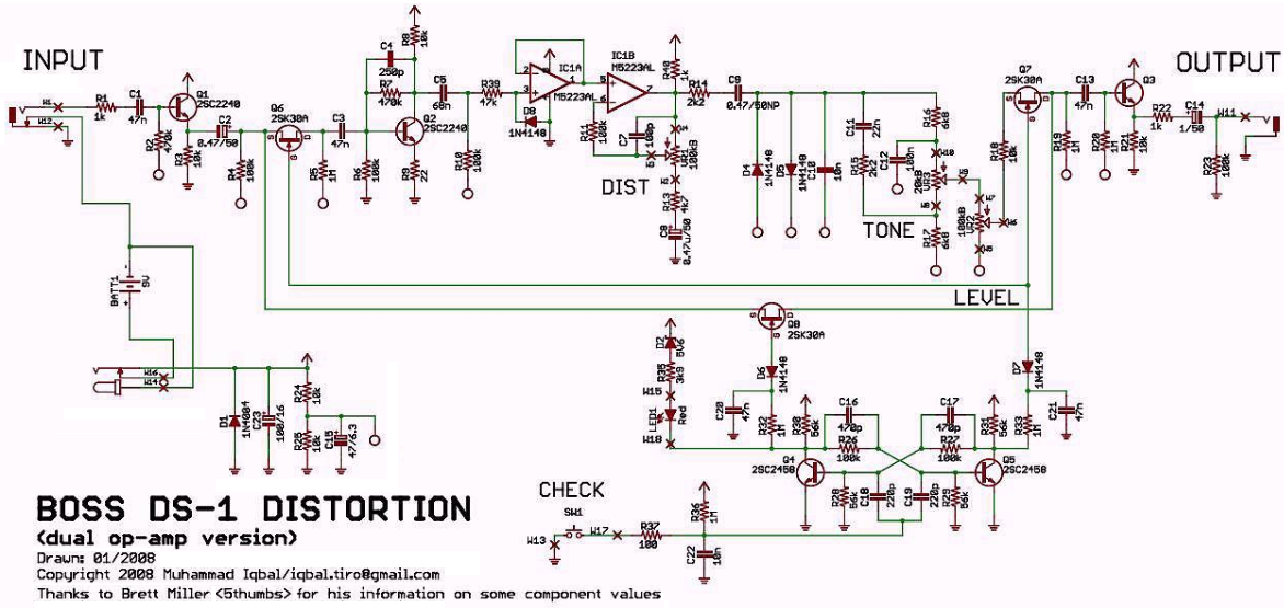

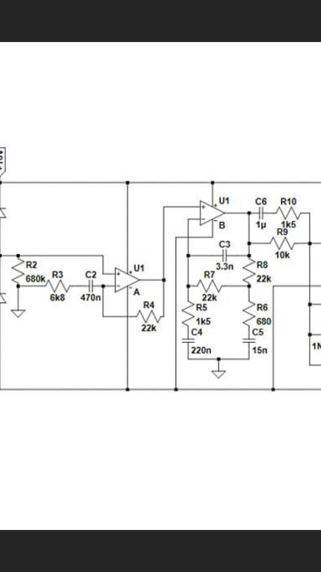

My question relates to two circuits for overdrive sections for guitars. See attached.
In both instances the second opamp’s + input is directly connected to the output of the first opamp. I was taught that the + input should usually be ground referenced via a resistor.
How do these circuits get away with this and not using any resistor here?

You were taught (or understood?) wrongly, it merely needs a DC reference to 'somewhere' - in this case it's the output of the previous opamp, which is most likely at 'ground' anyway, and is an extremely common connection.
That's typical for an inverting configuration, but those op amps are connected as non-inverting amps.
