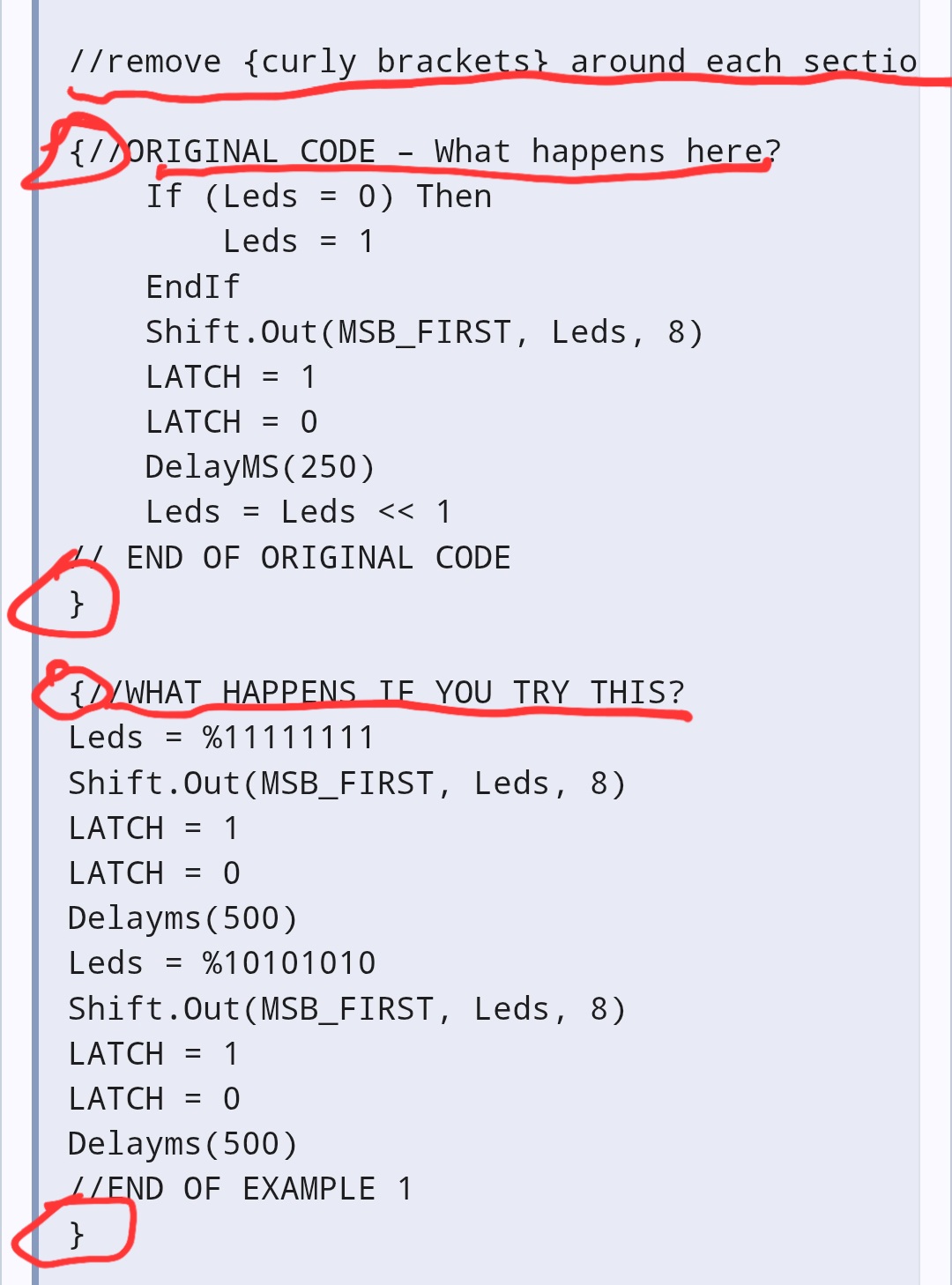

pOST#43 DOES NOTHING. I would like to be able to use the 8 bits that Jon posted ($11111111)
Going to look at it better as well as the SPI mssp that Tumbleweed suggested.
Geez oh grief. Did you even LOOK at the code? The code was written so you could try three different options so you make get a clue, but it would take some effort.... perhaps 30 seconds total. If you had even looked at it you would have noticed:

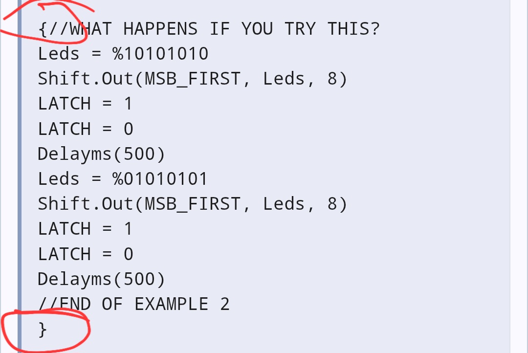

Did you even look at the code? Did you not notice that virtually all of it was light blue like a comment.
Remove the curly brackets { } around one section. Try it out. Put them back and repeat for the next section. Try it out. Engage brain. LOOK AT CODE AND TRY TO UNDERSTAND THE DIFFERENCE.
I saw how lost you are with this and that you don't understand that you can control each and every LED individually by changing its associated bit and shifting the ENTIRE SERIES OF BYTES OUT, so reluctantly I made an absolutely worthless attempt to help you once more. F**k me. I am so stupid for trying.
You'll say "I didn't understand the curly brackets." Bull excrement. You've been butchering Swordfish Basic for a dozen years or more. Not my fault if you don't understand the simplest features.

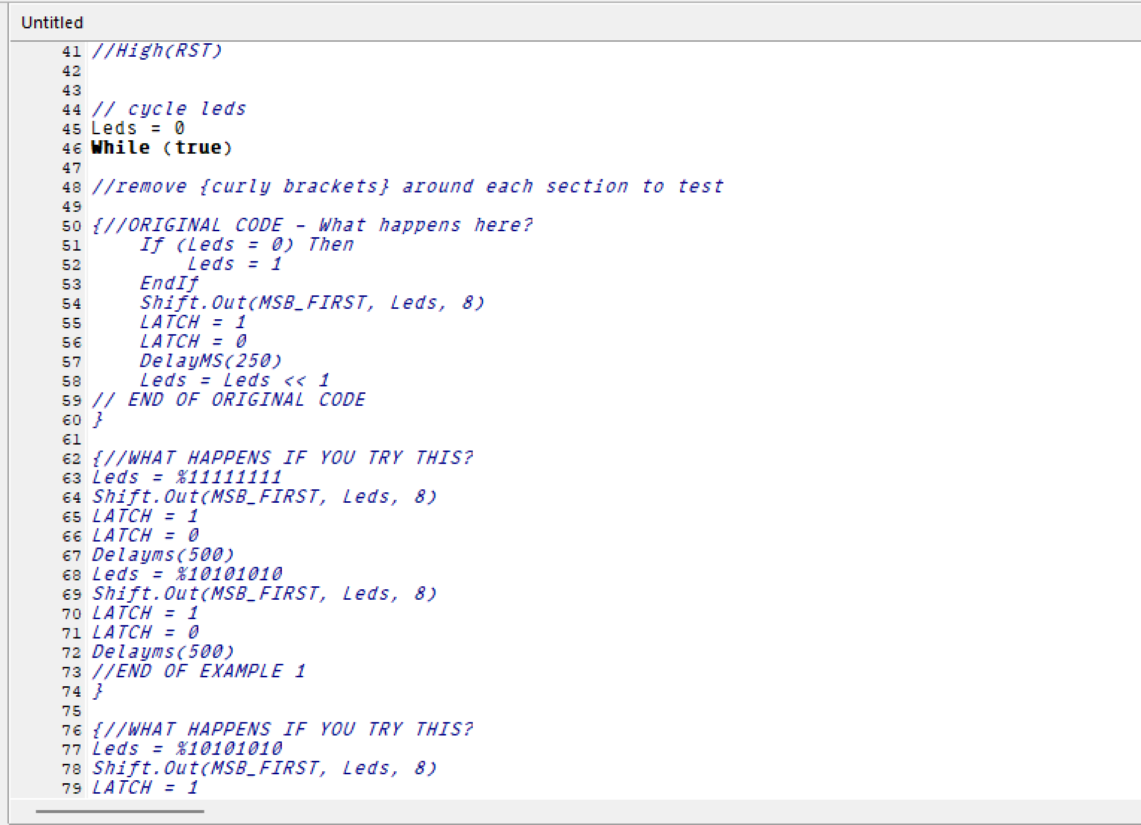

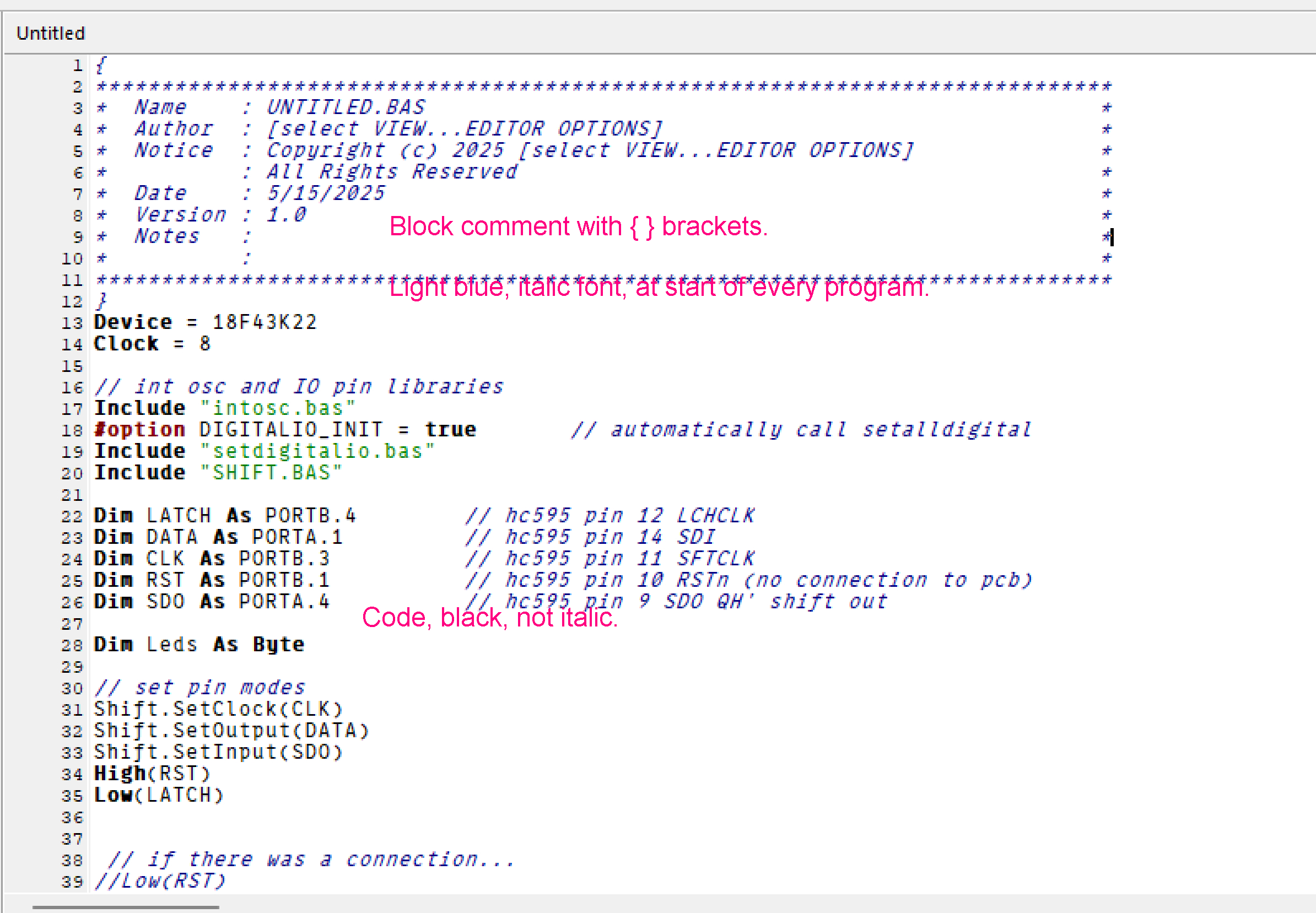

For those playing along at home, here is the code shown in the Swordfish editor.
For those with normal visual acuity and several interconnected brain cells, you can see:
> Code is black, non-italic font
> Comments are light blue, italic font
In the attached PDF, you'll see MrDEB is right - between the WHILE and WEND of the main program loop, there are only comments, with the instructions to test each section by removing the curly brackets. This would be OBVIOUS to anybody attempting to understand the code.

I missed some cuely backets that are kind of hidden (see line 50 and 62)
The Curley cues should be IMO not buried like {//.
Should be
next line of code.
I'll admit I was surprised that Jons code didn't work at first but after discovering the hidden Curlys and taking more time to read the code.
MY BAD
BOTH SUGGESTIONS WORK. exactly what I am looking for
