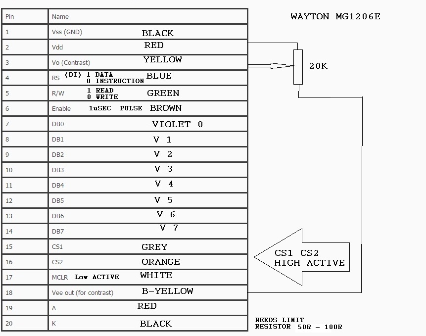

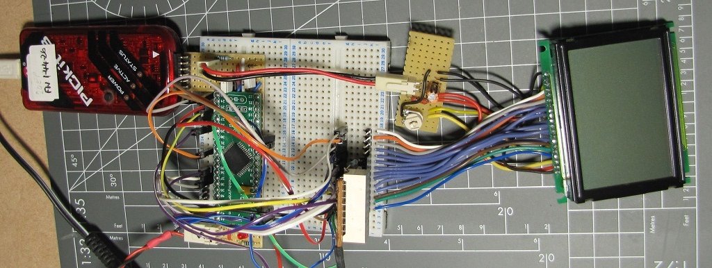

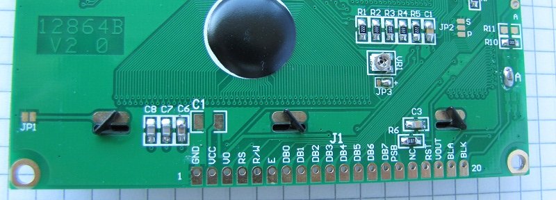

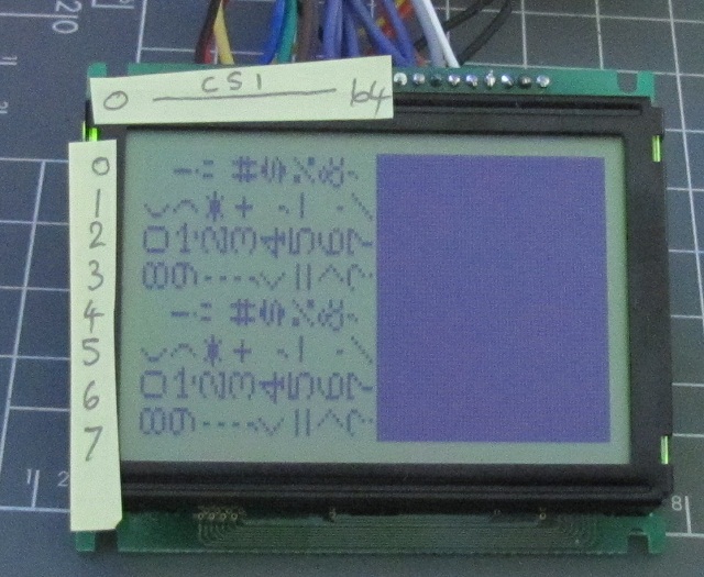

I had this 2.5” 128x64 GLCD (WAYTON MIT MG1206E SGL) in my parts box , and in a crazy moment I thought I would see if it worked ( It was from a Maplin grab bag of led / lcd junk) , found some data on the www and lashed up a test bed, having realised graphics LCD require big-ish data squirted at them I used a dsPIC33EV256GM104 it is has 16k ram available. ( no details of the 20 pins on the pcb ) several days later ….. success. Well some lines on the screen, seems NT7108 / KS0108 controllers are not all the same, this one has a high level CS1 and CS2 ,( Left and right side controllers) not seen any mention of this on the files / posts found on the web. So though I would share. My intention is to write fonts / graphics into an array in PIC memory and just display that….
( colours are just my BB wire reference ).

Long time I do not use one of these. From what I recall, not all manufacturer use CS1 ans CS2 in the same way. Besides the allocation of pins, that is what distinguish GLCDs from each other.
Hola granddad,
I inherited from a failed replacement (difference in pins allocation) a brand new one. :)
After searching for the datasheet of a quickly vanished manufacturer in Brazil, I realized that there were kind of discernible patterns among the variation for different brands. :happy:
I finally compiled the data from several tens of datasheets and based on the pins allocated to power I could use mine successfully. The data is shown in the attached pdf. With my "electronic" PC down, it is good I got a proper back up handy. Hope you can wade through it.

I now have 2 more 128x64 GLCD modules to play with , a Winstar , ( blue white) , 15GBP from Rapid and an 'unknown' from China ( cheap) , this last one looks interesting, seems to be similar to the character (HD44780) LCDs , the single controller (ST7920) can do 8 bit or 4 bit parallel , or serial ... (SPB pin) and has build in character font .

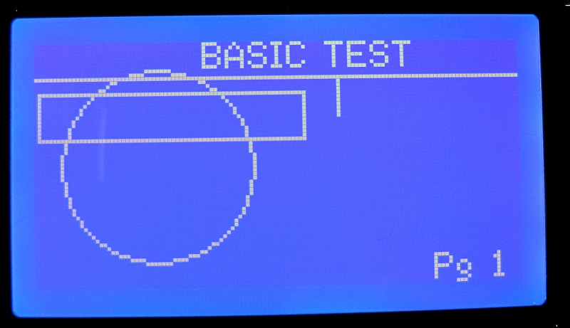

Looks like good progress. I notice the odd spacing on the font above. I used a 5 byte wide proportional font and used 0x55 for bytes that should be ignored. If you modify your code it should look a lot better.

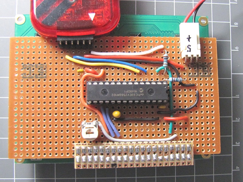

0x55 = Got you Mike .. Lashup has condensed to 28pin dsPIC33EV , but could do with some spare I/O pins , I was planning to take GLCD RST to Vdd and W/R to Gnd. as I don't think I need to read the display ram or busy status.. ? appreciate your ( anybody's) input ....
For 2x16 and 2x20 LCDs I use a fixed delay, so no check of busy condition. Pin is, IIRC, grounded.

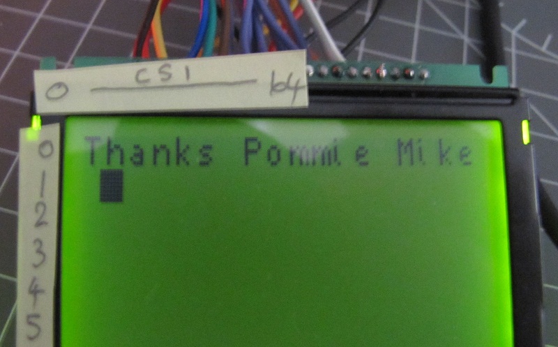

Moved up to the larger Winstar 128x64 blue display, and thanks to Pommie Mike's file , have the basics working , with RST at Vdd and R/W to gnd . Invert options and font spacing sorted, the dsPIC33 , works well only used 2% of program space ... also have a few pins to play with .
Looking good. The main drawback with those displays is there speed. If you update a value every 0.5 second it becomes unreadable. Shame really as they are otherwise very useful.
